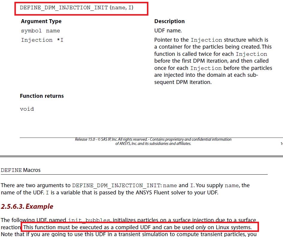

      Hello,nGreetings! I am experiencing same error since last 3 weeks. I also posted earlier about my problem. As I am getting error during initialization, one of you told me I have problem with DEFINE_DPM_INJECTION_INIT . Other recommended me to allocate UDMI before compiling UDF and to use double precision . I followed last two recommendations but still same error. However, someone told me to set counter so that I can isolate the error. Here is my DEFINE_DPM_INJECTION_INIT ,would you tell me how can I set counter here or inside any other udf?.DEFINE_DPM_INJECTION_INIT(entrainment_inj,I)n{nParticle *p;ncell_t c;nThread *tc;nnloop(p,I->p_init)n{nc = P_CELL(p);ntc = P_CELL_THREAD(p);nP_POS(p)[0]=C_UDMI(c,tc,6);nP_POS(p)[1]=C_UDMI(c,tc,7);nP_POS(p)[2]=C_UDMI(c,tc,;nP_FLOW_RATE(p)= C_UDMI(c,tc,5);nP_DIAM(p)=p_diam;nP_VEL(p)[0]=C_U(c,tc);nP_VEL(p)[1]=C_V(c,tc);nP_VEL(p)[2]=C_W(c,tc);nC_UDMI(c,tc,9)=C_U(c,tc);nC_UDMI(c,tc,10)=C_V(c,tc);nC_UDMI(c,tc,11)=C_W(c,tc);n}n}nAnd my error is same at the time of initialization,n999999: mpt_accept: error: accept failed: No errorn999999: mpt_accept: error: accept failed: No errorn==============================================================================Node 0: Process 18384: Received signal SIGSEGV.nn==============================================================================nn999999: mpt_accept: error: accept failed: No errornn999999: mpt_accept: error: accept failed: No errorn999999: mpt_accept: error: accept failed: MPI Application rank 0 exited before MPI_Finalize() with status 2nThe fl process could not be started.nnThank younAnadin

      Thank you YasserSelima ! I will use this code tomorrow. But will you check the attached image. In the ansys udf manual I see that DEFINE_DPM_INJECTION_INIT can be only used with Linux system. But I am working on Windows machine. Can I still use DEFINE_DPM_INJECTION_INIT on windows system?nn
    • YasserSelima
      I am not sure. We have nothing to loose. Let's debug and see where it stops.nIf it gives you an error in the lineni++; nreplace it withni=i+=1;nn
