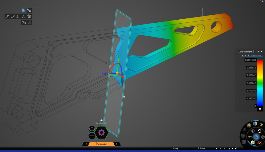

Hello TNoguchi
If you enable the Cut Plane option from Results Arc, then select the cut plane, the Move handle with arrows appear for orienting the plane as required. See below snapshot. Is this what you are looking for?
