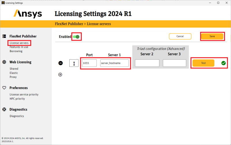

You will need to download and install the ANSYS License Manager and install the license file.
Installing ANSYS License Manager 2023 on Windows
After doing so, you can set the Server specification using the Client licensing Settings, so that the program will check out the license.
Ansys client settings configuration
  • "Enable" the Ansys client licensing settings.
  • Enter the port and hostname or IP address of your license server. Use 'localhost' if the Ansys license manager is running on the same computer.
  • "Test" the setting to confirm the license server configuration.
  • "Save" your settings and the utility.
You should now be able to run the Program
