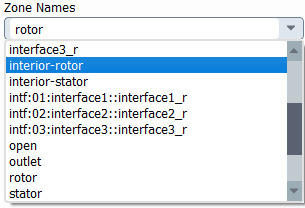

Yes, I have a Mesh Interfaces between the rotor and stator. So, I'm going to set the 6DOF option to passive for the cylindrical fluid zone. Can I assign the stator as stationary or it is unnecesary? and the zone names that I am going to set the 6DOF option to passive are going to be all the zones that make up the rotor, such as the rotor itself, the (3) interfaces and the interior - rotor?
And will all the zone names with the "6DOF option to passive" of the rotor have the same 6DOF properties (mass, moment of inertia) as my turbine, or will I have to assign another 6DOF properties for those zone names?
