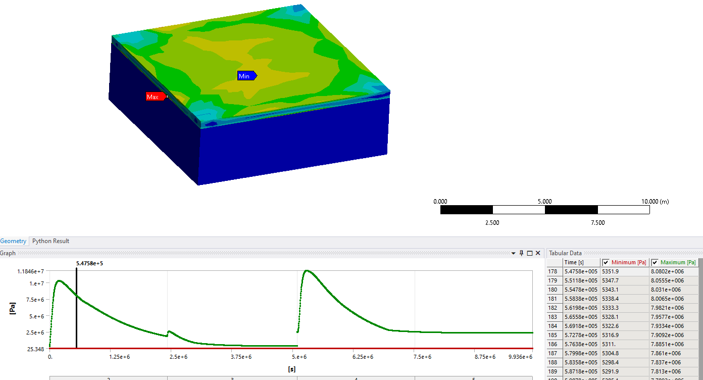

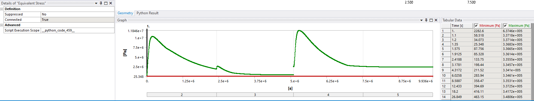

My interest in the “Retrieve this Result” button is only to display another time step. For a normal result, displaying could be done by clicking on the graph; however, you can enforce it changing using the retrieve option. I wrote about this option, thinking it should be similar in the python result. As of now, only the first time step is shown unless I change the time step used in the code.

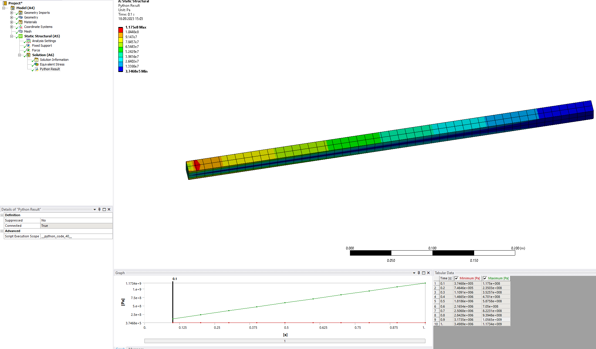

My result looks like this, no play/stop button. May it be because analysis is Transient? I wish to see python result produced by the gauss to node operator at any time step, but it doesn’t work for me at the moment.
