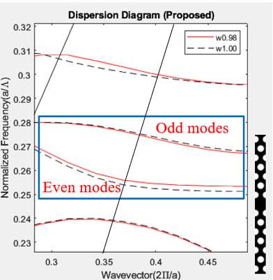

Odd and Even modes will appear when there is a defect such as a line defect between mode gaps like in Figure 5 below by using MPB but it did not appear when I did by using Lumerical software.
Figure 5 PhC structure with Line defect
