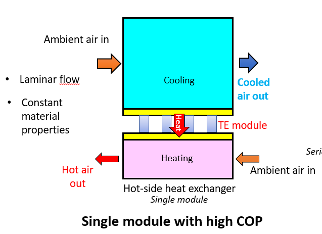

Now is always running. I have to reset System Coupling every time that I run a simulation.
Nevertheless, I am getting a 0 K temperature which is impossible.
This system is an A/C system that uses a Peltier Cell to change the temperature of the air. Peltier cell is located between two air channels.
I am wondering, what is the best way to simulate it?
Currently, I am using Thermal-Electric for the Peltier Module and Fluent for the air and the fins.
The variables that interact between Fluent and Thermal-Electric are Heat Flow and Temperature
