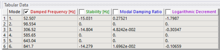

I made a model with a spring-damper so there would be some mode-dependent damping.  Then I ran the modal with a damped solver (Reduced Damped.)  After the solution I highlighted Solution (A6) and got the table below.
