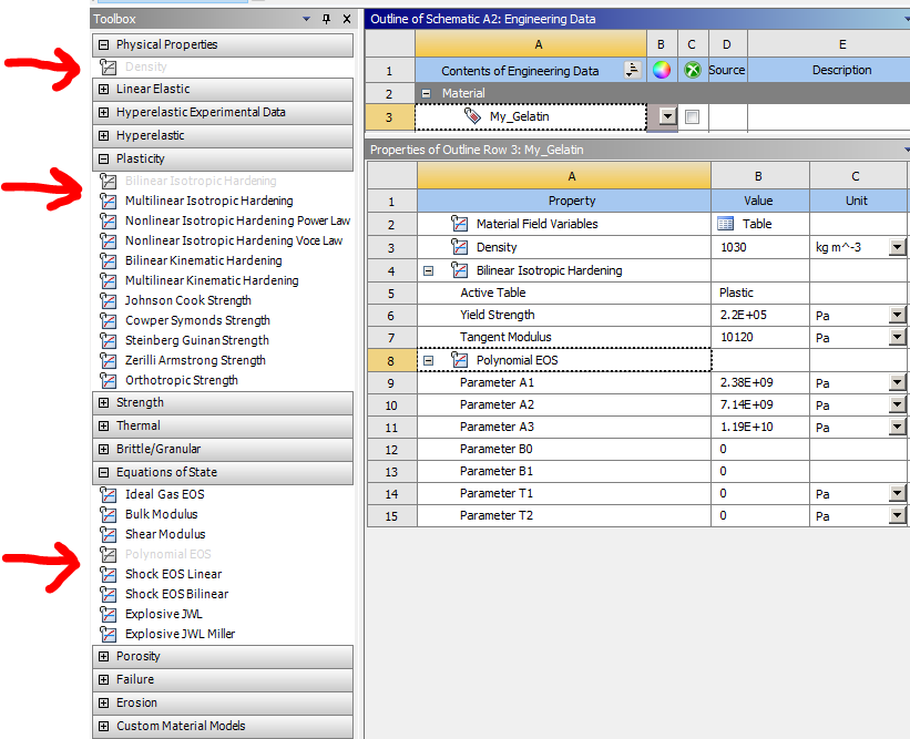

If you are using Explicit Dynamics system, you can use Polynomial EOS and Bilinear Isotropic Hardening directly in Engineering Data to create the material. See attached picture below.

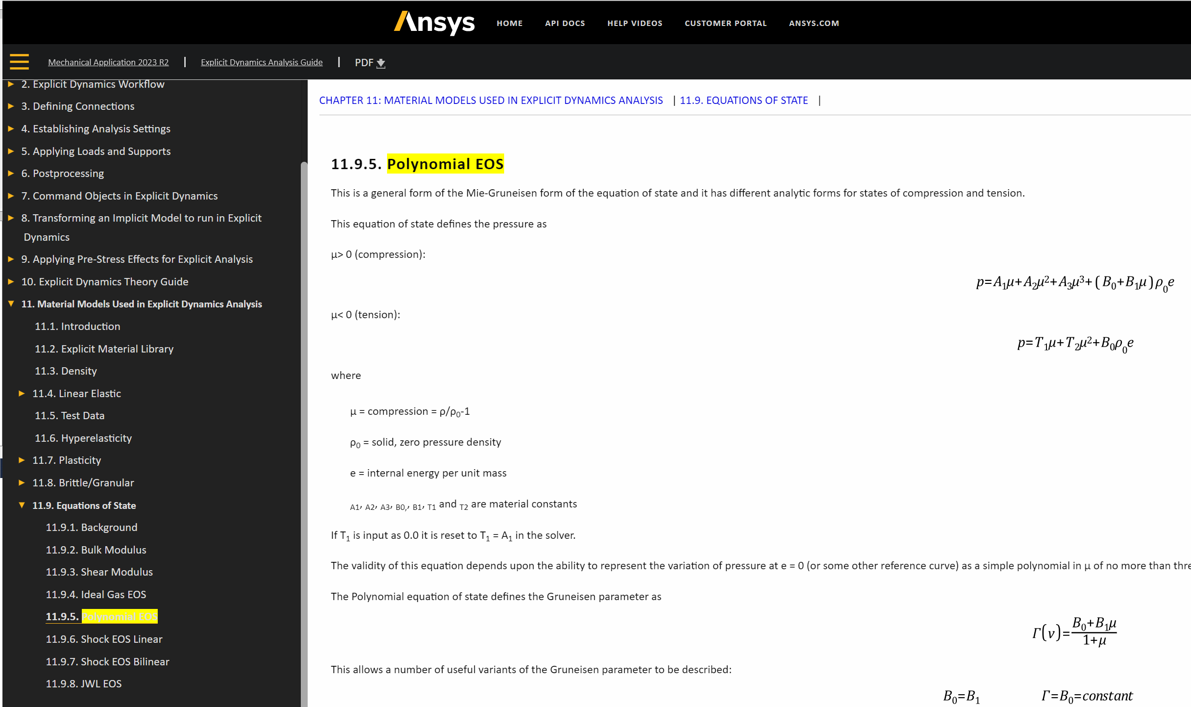

Here is the reference material from ANSYS Help:
11.9.5. Polynomial EOS (ansys.com)
