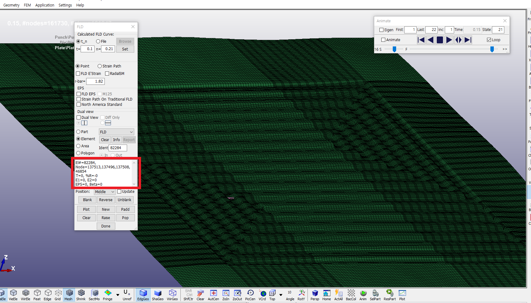

Thank you for answering.
It wasn't that i didn't find the way to point the mesh in fld plot, but my fld values were strange.
Any mesh i choose, the values like t, %R, E1, E2, EPS, Beta is all zero.
It's same to each mesh all.
So i guess all mesh were pointed in origin in fld plot.
Is this because I designed the punch, plate, die as a shell surface model?
Why is this like this??
I will very appreciate if you help me little more.
