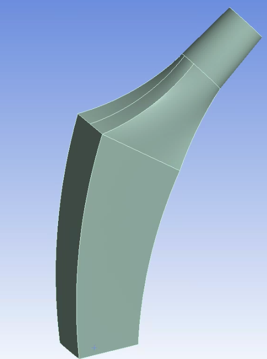

excusme sir, about sweep methode
if i have geometry like this
which surface should be used as source and target? because previously I used automatic mode
after i do your advice, i try to add edge sizing in the top of my geometry (cylindrical surface) and it work, but this is a little difficult because I have to do a different edge sizing for each mesh size that I enter during the grid test
