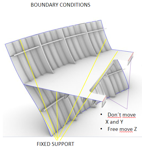

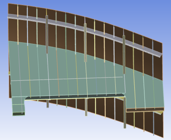

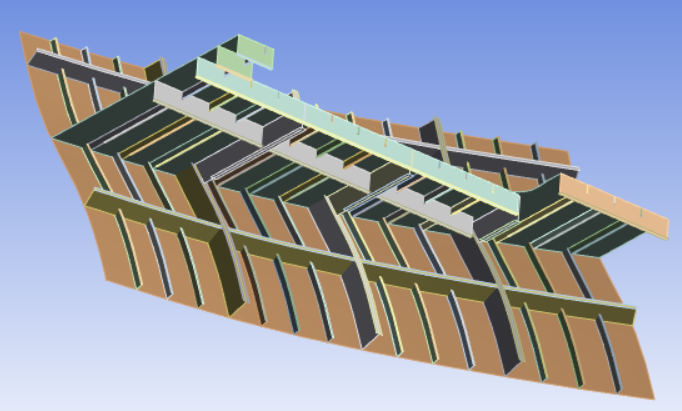

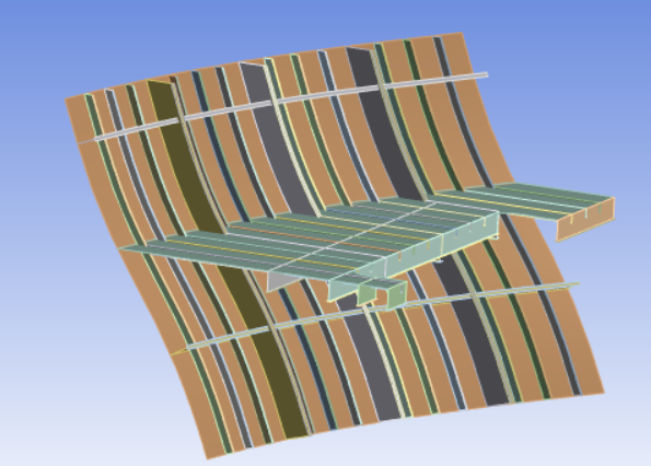

Hello Peter, thank you for your reply. This is the section the ship, this geometry is between two watertight bulkheads (bulkheads are not included) and two decks (decks not included). Because of symmetry we did just one side.
We try to simulate the vibration produced by onboard machinery and see the response of this vibration in the geometry. To include vibration, we thought we could include it as a displacement.

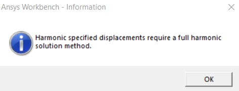

  1. Playing around with the program we realized that we can’t include a displacement when using the mode superposition method. Why is this happening?
    So we did a full harmonic solution method, and we saw that Displacement and Nodal Displacement can be applied. What is the difference between them?

  4. These are the boundary conditions for the geometry, we are going to consider to expand this geometry since applying fixed supports in the borders near the region of interest, will affect the asnwer. Do you have any recommendation for boundary conditions?
  5. We have seen that in harmonic module it is included some boundary conditions, are they for the whole geometry or for some sections where the vibration is located?
