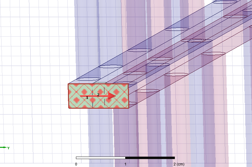

I completely understand that lumped port has to be attached but the concern is how may I put it on the structure. Unlike CST, which I have been long using, Lumped port is also messing up S-parameters, I have checked that in case of a “Fat” Pipe dipole and compared with CST.

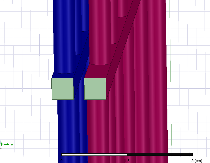

The signal is to be fed from the top of the structure of each boom. So do I need to assign 2 lumped ports over the top faces of 2 booms with 180-deg phase shifted (like in the figure 1), here two greenish squares are representing two different lumped ports. The integration lin is upward in first port and downward in second port.

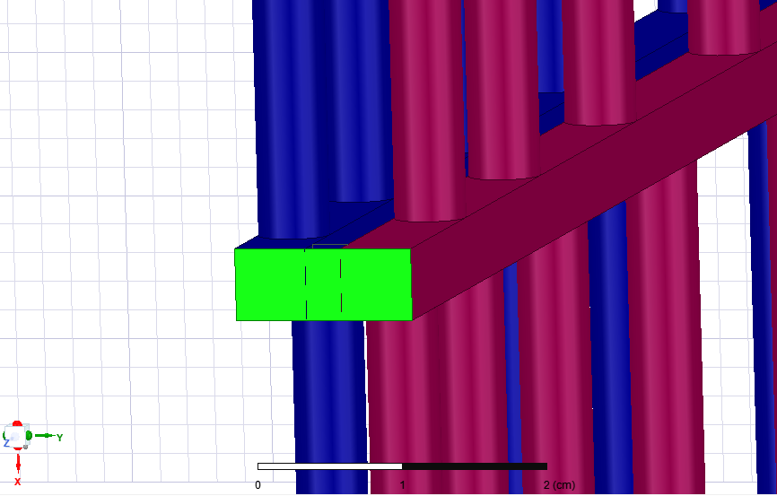

Or shall I connect a single “Lumped port” covering the faces of both the square booms and the integration line to be difined from the center of face of boom 1 to center of face of boom2, as shown in the 2 figures below.

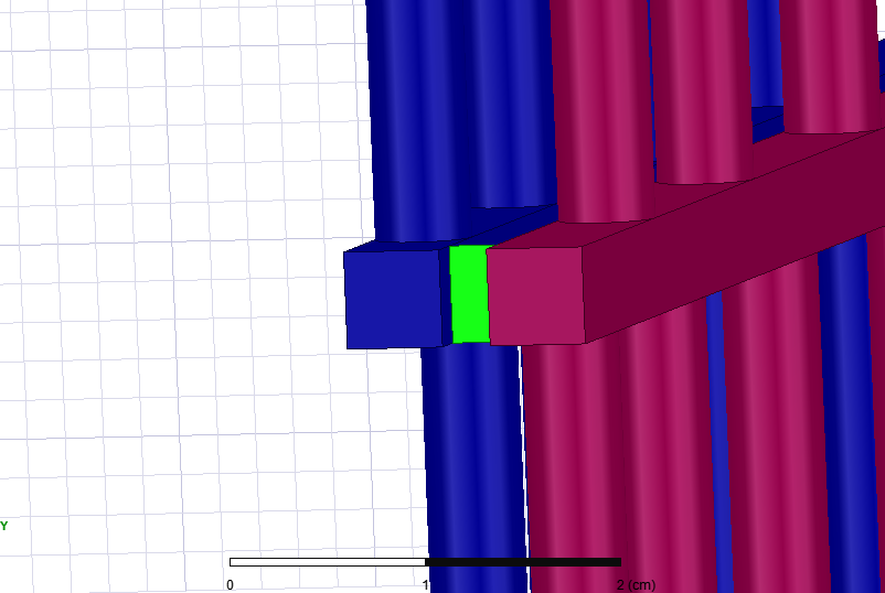

Or, Do I have to connect the lumped port in such a way so that it connects both the booms by-side as show in the figure below.
Although, I have tried all these ways to assign the excitation but didn’t find expected results. So, I presume that I might be missing something here. Kindly, let me know about it.
Also, simple “stub” drawing essentially works in CST but here it is not working and therefore I have attached a Lumped-“series”-RLC element (R=300 ohms, L=C=0) at the bottom of the booms as last figure (but at the bottom), so that the rectangle touches sides of the two booms, Integration line has been drawn from the surface of first boom to second boom. Is it the correct way to assign the lumped-load ?
Kindly let me know where am I possibly comitting mistake and how to fix that.
