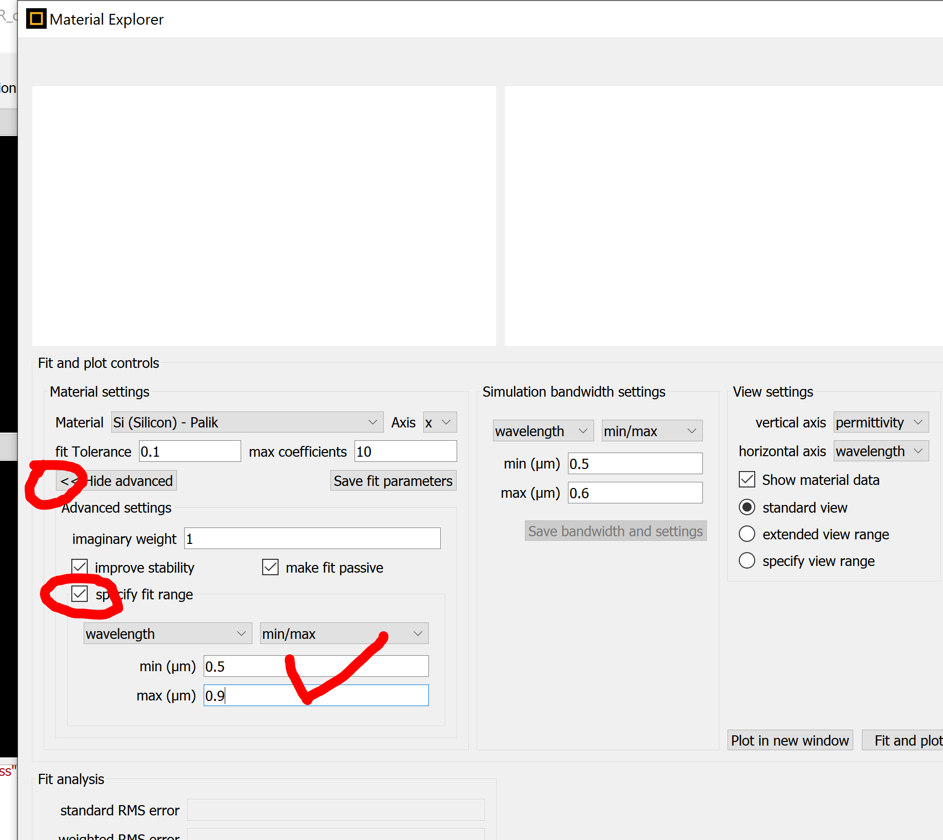

To alleviate this problem, please fix the mesh generation and material fitting wavelength range. You can use this:
or more specifically, set them in mesh generation:
and fitting:
They should lead to the same result. Please try.
