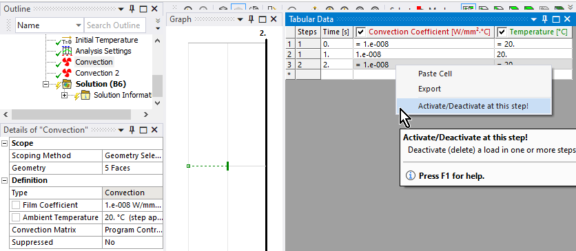

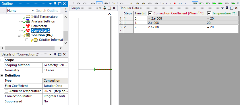

Ansys Learning Forum Forums Discuss Simulation General Mechanical I am not able to apply two convection boundary conditons at different time intervels. Reply To: I am not able to apply two convection boundary conditons at different time intervels.
peteroznewman
Did you try to use Activate and Deactivate on the two convection BCs in a multistep solution?
