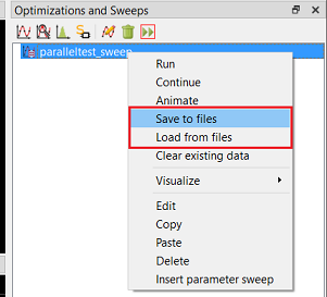

For parameter sweeps,
You create the simulations/sweeps in the CAD/GUI on your local machine (pre-processing). Save the files and copy this over to the supercomputer.
Run the simulation files on your supercomputer.
After running the simulations. Load the files with the results into your local machine (post-processing).
