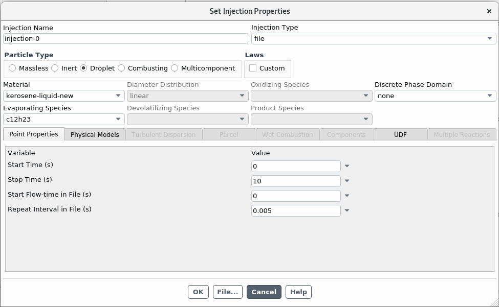

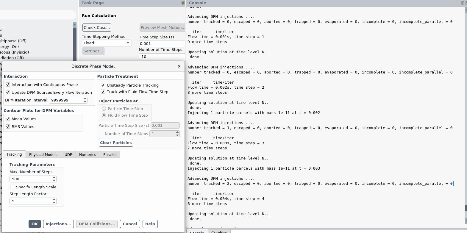

@DrAmine thank you so much for your reply!
I have tried your setup: actually it works fine, as you said!
Anyway, I used your setup while changing the injection time to 0.003[s]. It should work in the same manner, but simply with a temporal shift, am I right? instead I get the same problem
See the console log for instace (in bold the issue that I am seeing):

As unsteady tracking parameter I am using "Track with fluid time step", so it should be the same used to advance the flow-time. Also (see again the bold part in the log),there is a thing that is puzzling me: is the injection occurring at the beginning of the related time step? Why is reported "Injecting 1 particle parcels with mass 1e-11 at t = 0.002" if I have set 3e-3[s] as flow-time for the injection?
I put also some snapshot, I thought maybe could be useful to understand where I am doing wrong.
Thanks again for you help!
