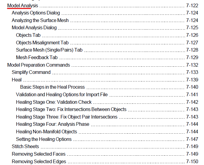

Hi @arshiah,nCan you decouple Maxwell from simplorer and run Maxwell alone and see if the issue persists with Maxwell alone?nIf the error still persists with Maxwell, then it could be due to a mesh problem. Perform below one after the other. n1) Try to simplify if there are any complex geometries in your model and analyze.n2) Change the mesh method to classic and move the slider a bit towards a fine setting in initial mesh settings.n
3)Refer to Model Analysis section in the Maxwell help section for more details on model analysis for the mesh.n
nRegards,nNavyan
