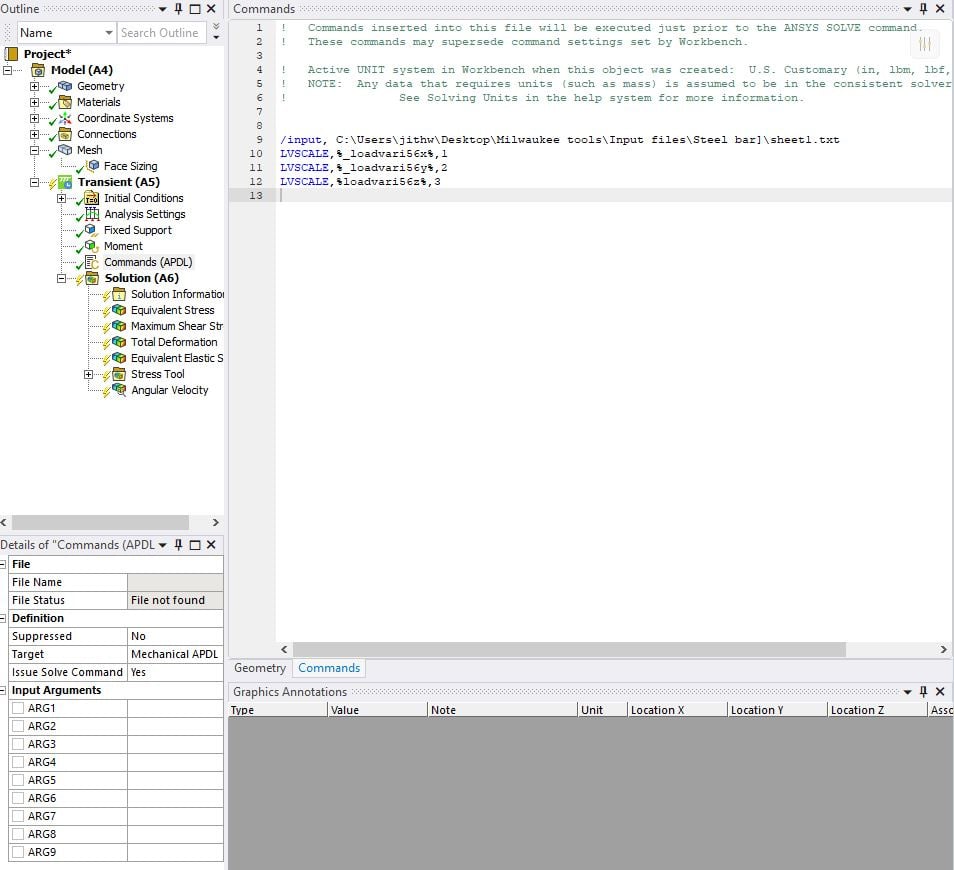

Hi. You just described the exact same issue that I have at the moment. I am trying to apply torque on an impact socket driver based on the experimental data generated by our team. The excel file has about 850000 entries for time and applied torque. I followed your instructions (generated an input file and inserted an apdl command snippet in the analysis section). However, I am having trouble proceeding further. (how do I link the Moment section to the command snippet?, do I have to assign parameters for each value?, why does the command snippet say file not found, and how do it change that status?)I would really appreciate it if you could detail what you did in your simulation setup. I can send you files if need be.nnThanks for the help in advance.nn
