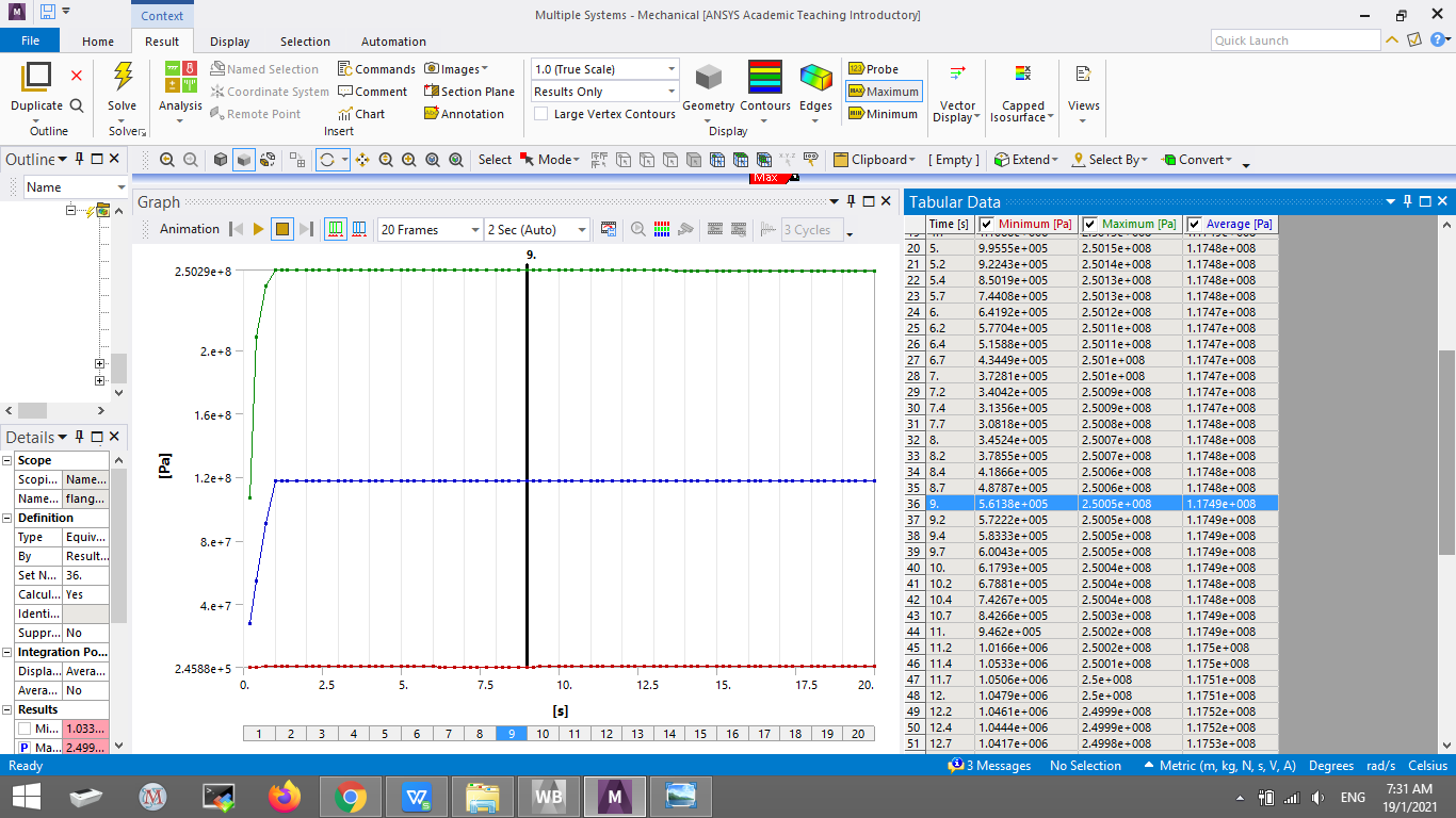

Hi, sir .nSorry, it's my bad for not clearly put the information.nOkay so here it is. I want to see how my flange changed when I increased the internal pressure. nThe first image shows the values of the pressure when I simulate it using the no of steps.n Then, the results when it is on the second image. (Result = 250.05 MPa)n Lastly, the results on the parametric analysis. (Result = 250.24 MPa)nWhen I compare both of them; for example at Pressure = 1.96 MPa, they're not showing the same result. nI don't know why and which way is more accurate to stimulate it.nn
