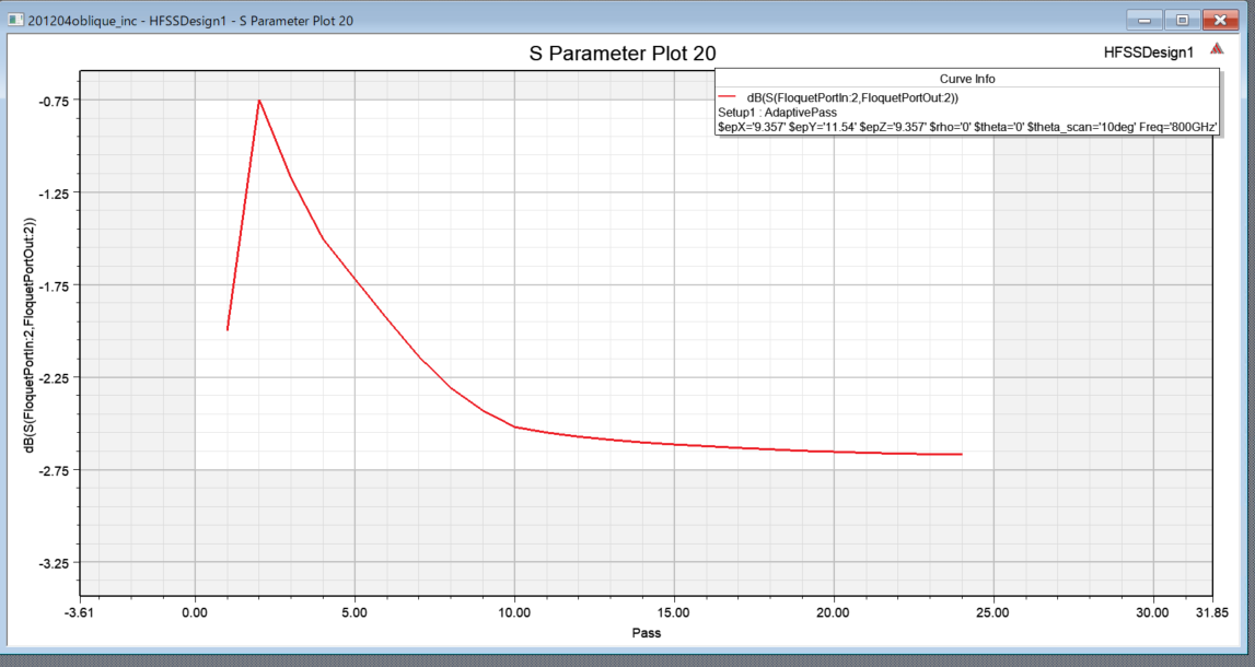

I set solution to AdaptivePass and I succeed to update and display the Pass - S-parameter plot.nI want to display the transmittance value in TM mode on the graph, but it seems that the value is different from what I expected. The value when Number of passes was set to 6 another time and the value at 6 this time are very different. nThe attached photo is the actual figure. The forecast is that the transmittance will be around -0.09dB and I cannot understand why the value changes so much.nCould you give me any other advise on what is this value displayed now and where to change the setting to see the transmittance ?.nn
