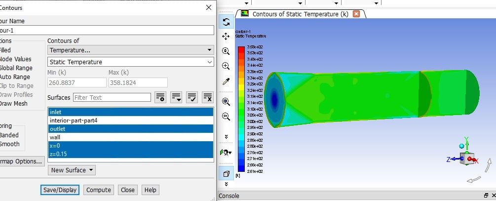

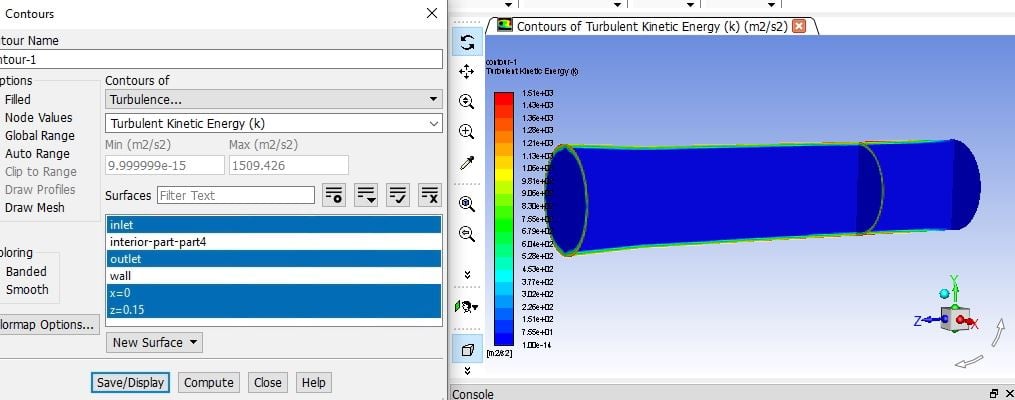

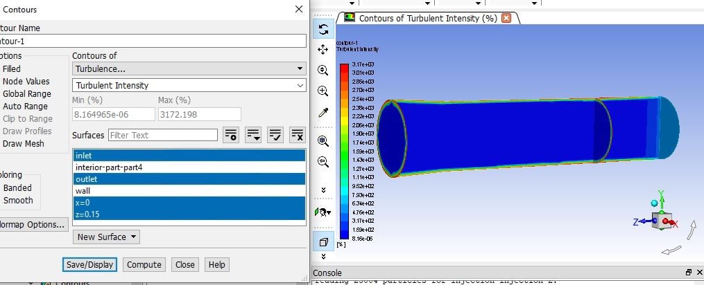

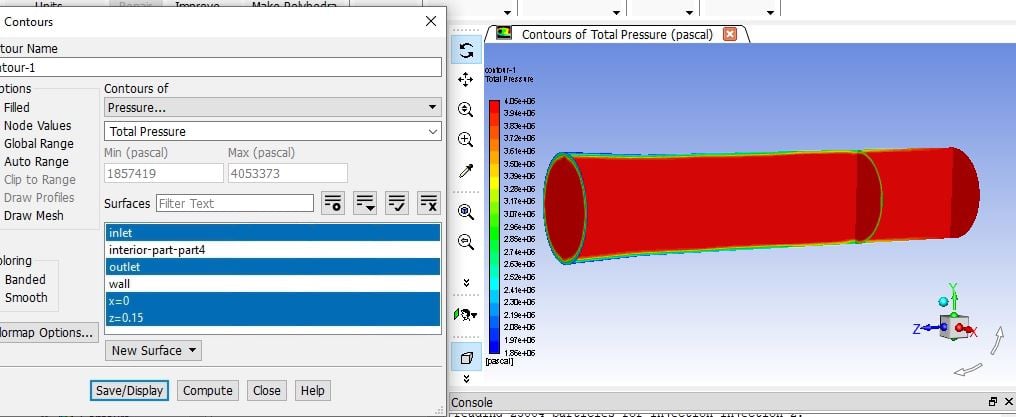

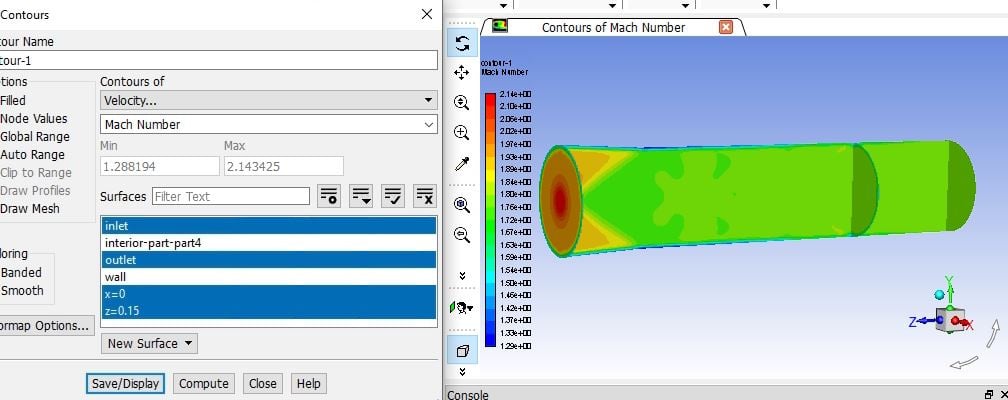

I removed oxygen and nitrogen from material. i run the simulation and injection was done. but it is almost unable to cool the compressible crossflow. Droplets can not penetrate in the domin.what is the problem?I have a doubt if i had simulate the compressible crossflow correctly or not.nstagnation pressure:4MPa - static pressure:0.696MPa - stagnation temperature:500k - static temperature:303.5k - Mach number:1.8nI set the operating pressure to zero.My boundary conditions are pressure inlet and pressure outlet.nI send contours of the domain.Are they correct and meaningful?nThe values of turbulent kinetic energy and turbulent intensity are very high.Are they correct?nBest regrdsnn
