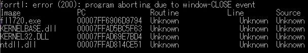

      I'm trying to operate Fluent in non-graphical mode from MATLAB using aas and TUI code, but when MATLAB send a command which make Fluent create dynamic mesh (following command), Fluent display the error(following image) and crushes.

      Thank you for the comment Kremella.nnWhen I run Fluent standalone, mesh set-up work correctly and I can obtain a converged solution.nThat's why I think the problem is Matlab integration.nIn addition to above error, bellow error also occurred when Matlab send below command.nnShoji.n
    • shoji
      I can fix this error, and the cause was my programming mistake.nHowever, I can't fix this error.n This occur when MATLAB send following command. nI calculate Fluent simulation repeatedly, and this command can work for first 8 times, but after MATLAB send this command 8 times, error occurred (9th time). nn

      Sure.nnWhat I want to do is running fluent repeatedly (about 100 times). And the name of the program to run fluent is Fluent_pitch and I repeat it by using below matlab program. nOf course I can run Fluent_Pitch correctly. However when I run fluent_repeat, fluent pitch run correctly for the first several times, then program stops at following code. nI said it can work 8 times, but this time it can work only 5 times.nThis is the video how the program work and stop.nArraynThanks.n

      HellonThank you for the comment.nnI tried step1,2 and 3 , and Fluent worked without error. However when I run fluent repeatedly from MATLAB error occurred.nAlthough Fluent works for the first several times, the error occurred at bellow program after Fluent run several times.nFluent run as follow program without error for the first several times.nnconnect fluent nload UDFncreate dynamic meshninitializenstart calculationnnThanksn
      If the system works a few times and then fails, what is different about the command or starting point?n
