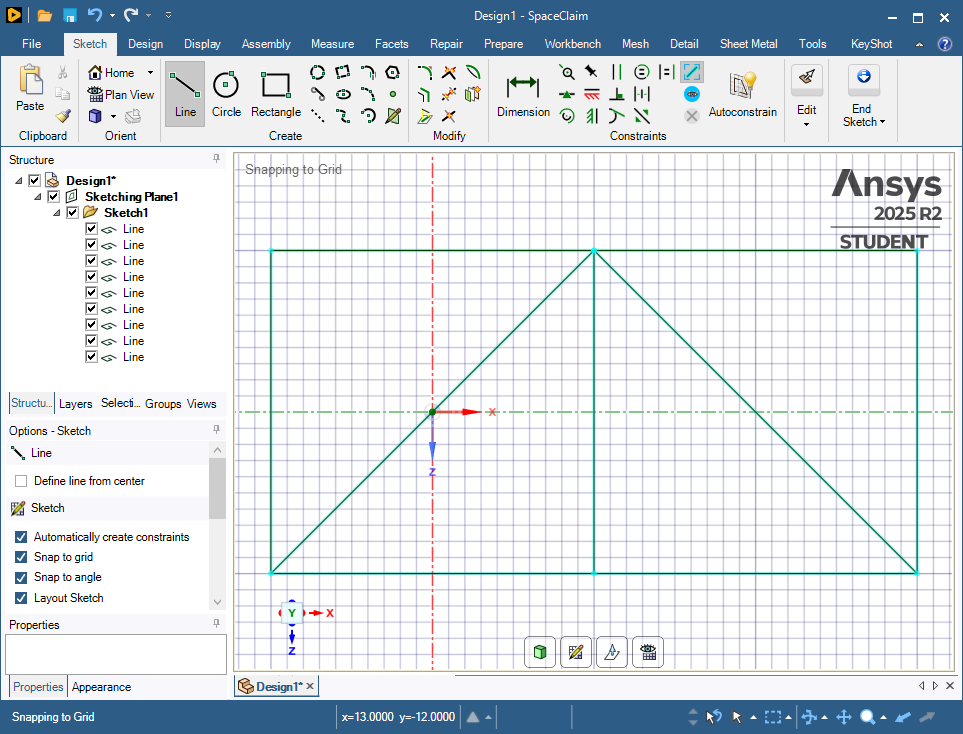

        For instance, as the figure below shows, there are splines of a simple truss. I want to sweep them by a section pattern(such as an "I-shaped" face). How can I sweep all of lines at once?

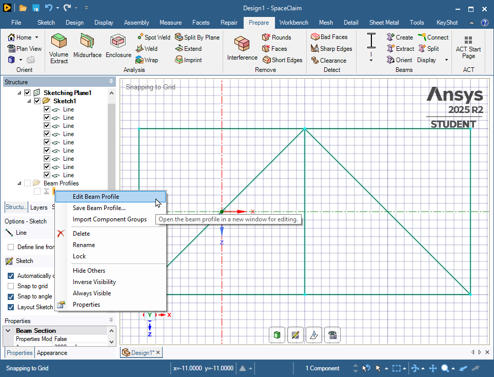

      With that image and some more description, I believe you wish to create beams with a cross-sectional profile such as an I-beam shape for structural analysis.
      Here is your truss created using a Layout sketch:

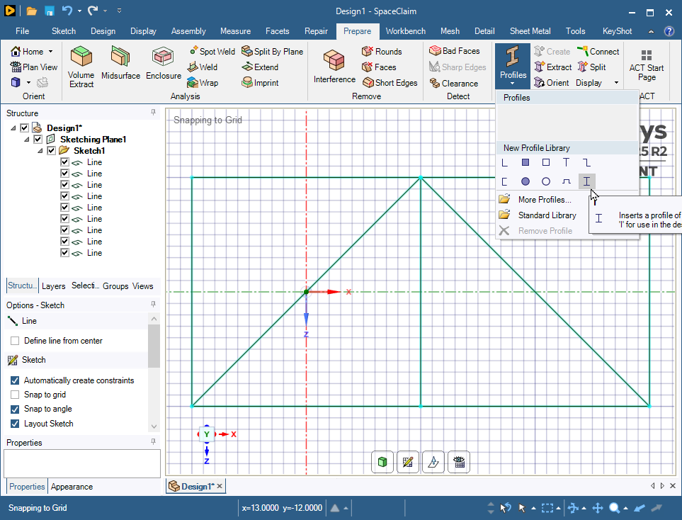

      Click on the Prepare Tab and pull down the Profiles button to select an I profile.

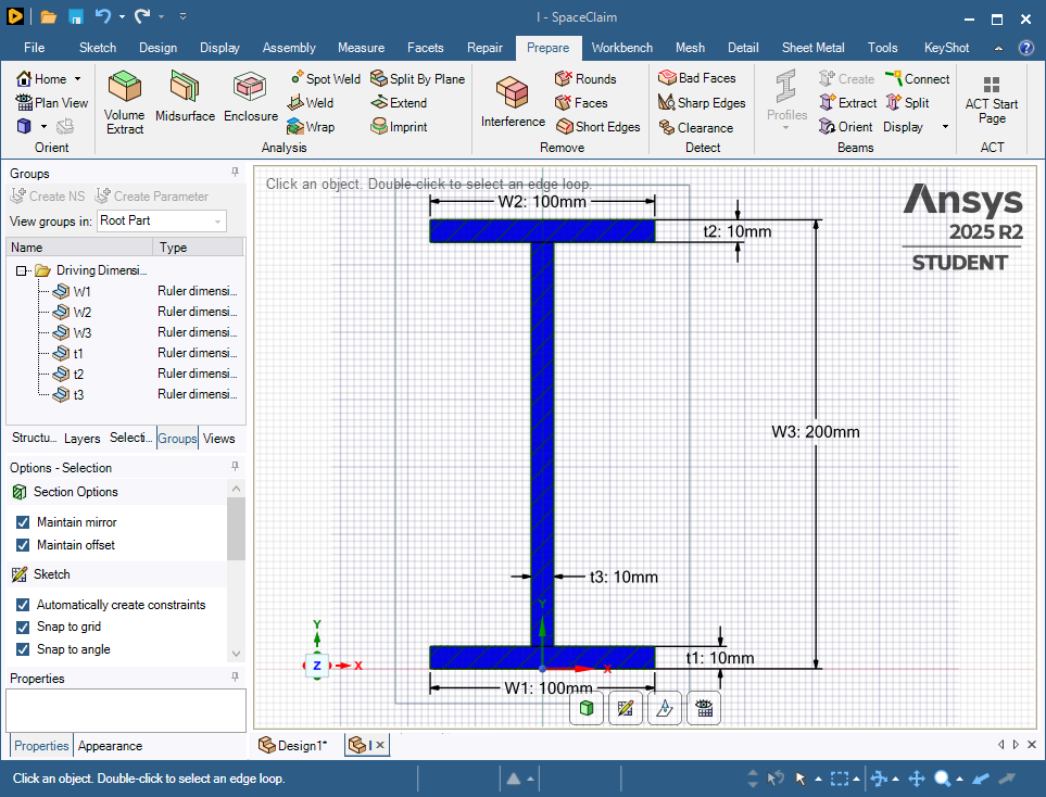

      In the Structure, there is an I profile that you can edit the dimensions.
      Now all the dimensions are available to edit.

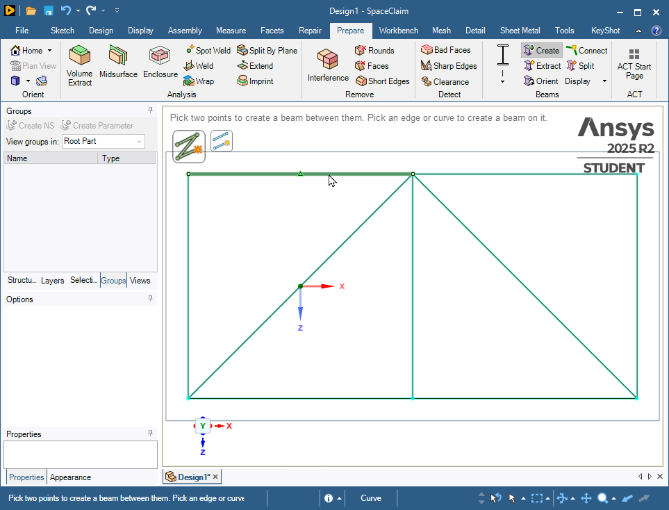

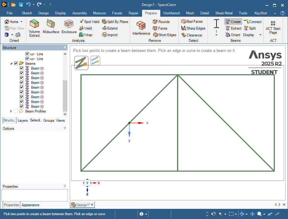

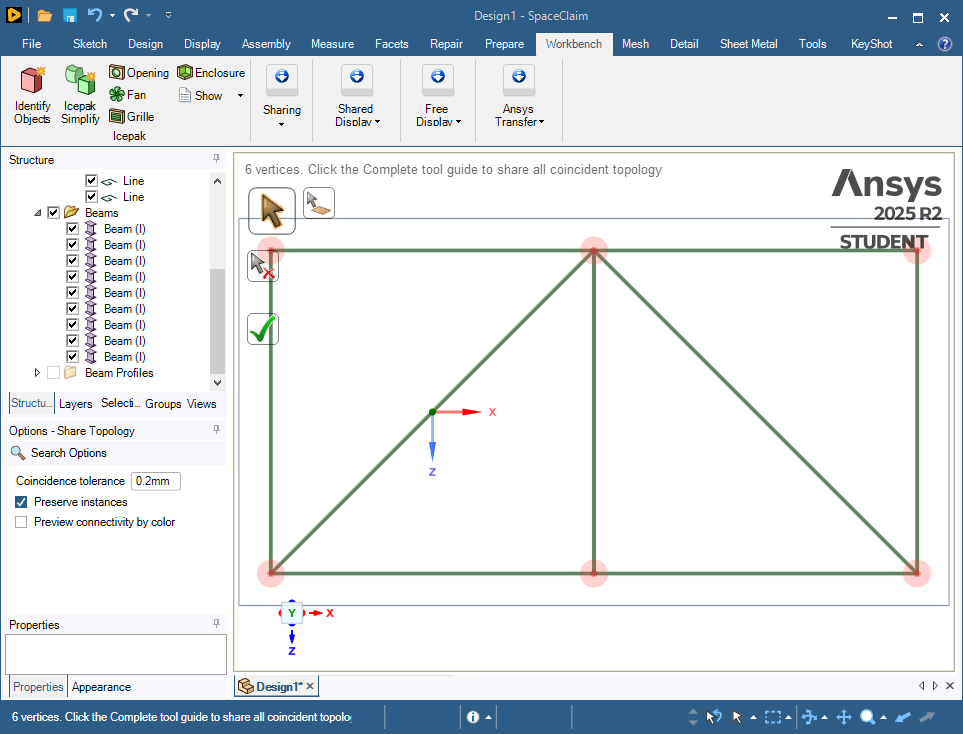

      You can close the I tab at the bottom of the graphics window to get back to your truss sketch. Now use the Create button to make beams from the lines. Every beam clicked gets the same profile.
      Click on the Workbench tab then the Share button then the green check to connect the beam ends to each other.

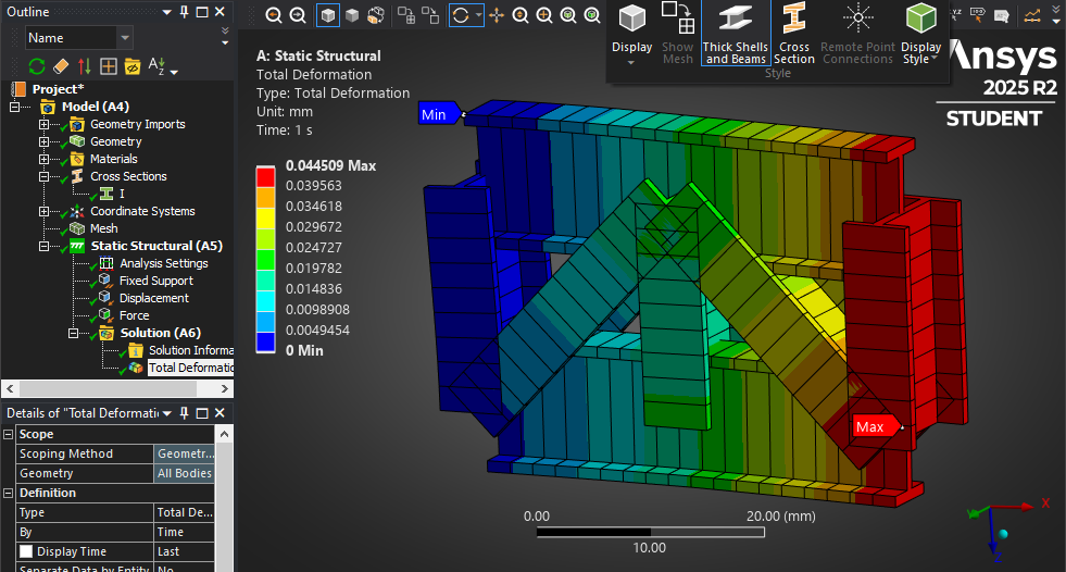

      When you open this file in Mechanical, you will have an I-beam structure that you can support and load.

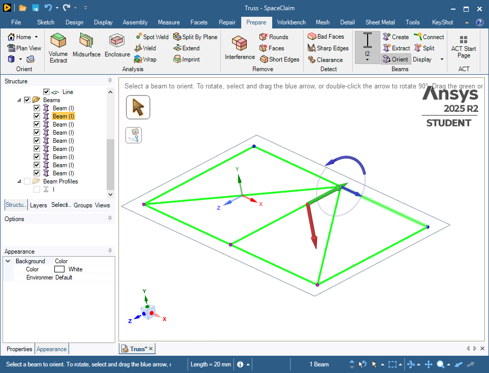

      Go back to the Prepare tab and click the Orient button if any of the beam cross-sections are not oriented the way you want.
      In Mechanical, on the Display tab, turn on Thick Shells and Beams to see the I beam profile orientation.
