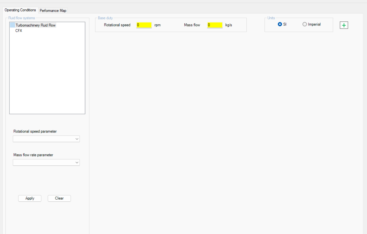

      Hi everyone, I´m trying to use CFX performance maps for postprocesing, but I´m not sure how to use it, when I open performance map´s module, its apears me this:
      the problem comes when I try to select one of the options, nothing happens.
      The design process I followed was the next one: First  I didn´t use VISTA  CCD for One-dimensional model, because I had my own 1D model, then I used BladeGen for 3D design and connected it to turbomachinery fuid flow, then when I made the simulations, I tried to open performance map´s module, and saw how it worked.
      I´m not sure if the problem is with the design process, or it´s something related witrh the parameters, i do not have any parameters asociated to turbomachinery fluid flow.
      Thank u, waitin' for your answers! :)

      Here's tutorial on how to use operating maps in CFD-Post: Chapter 39: Operating Map for a Centrifugal Compressor
