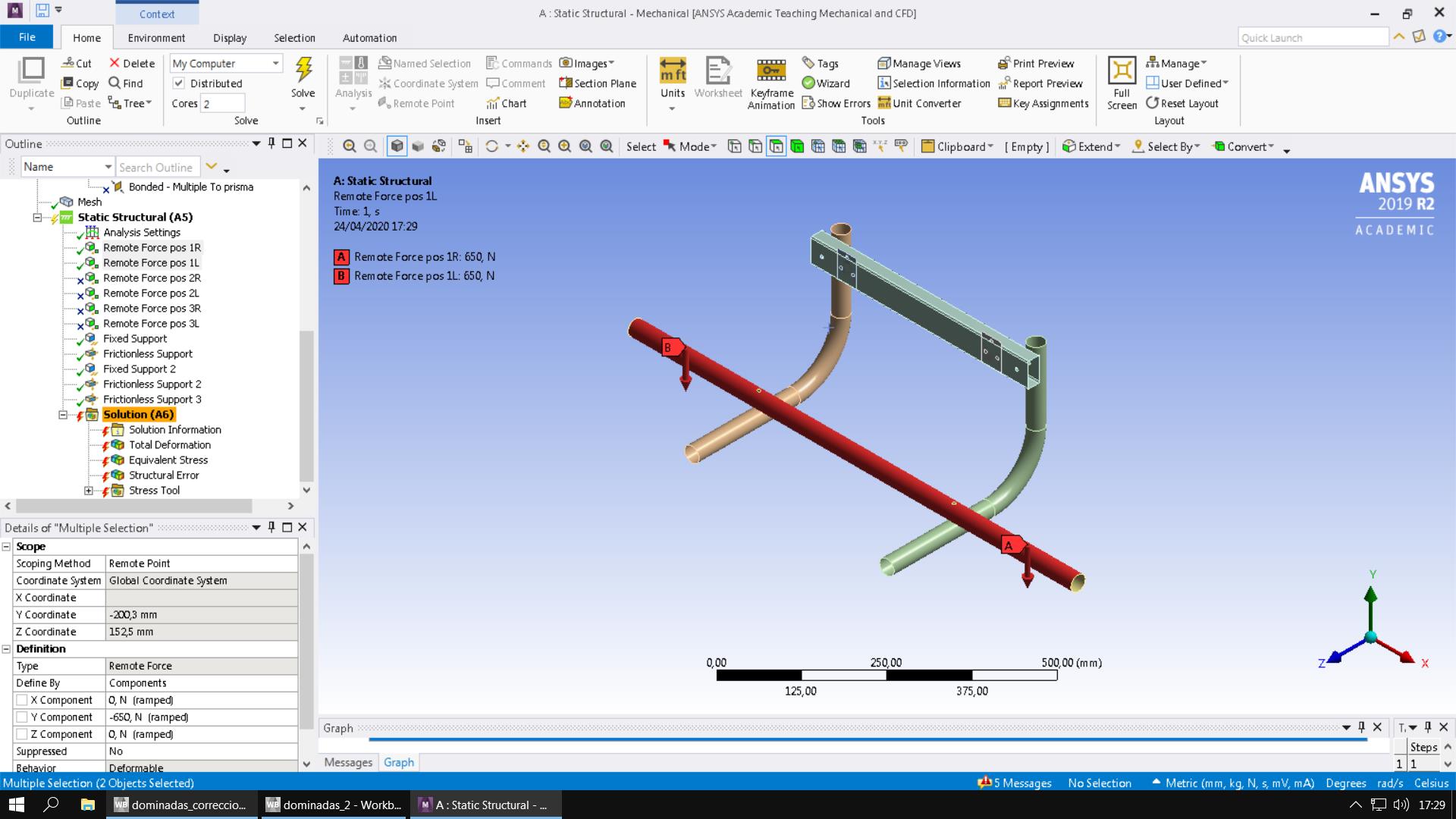

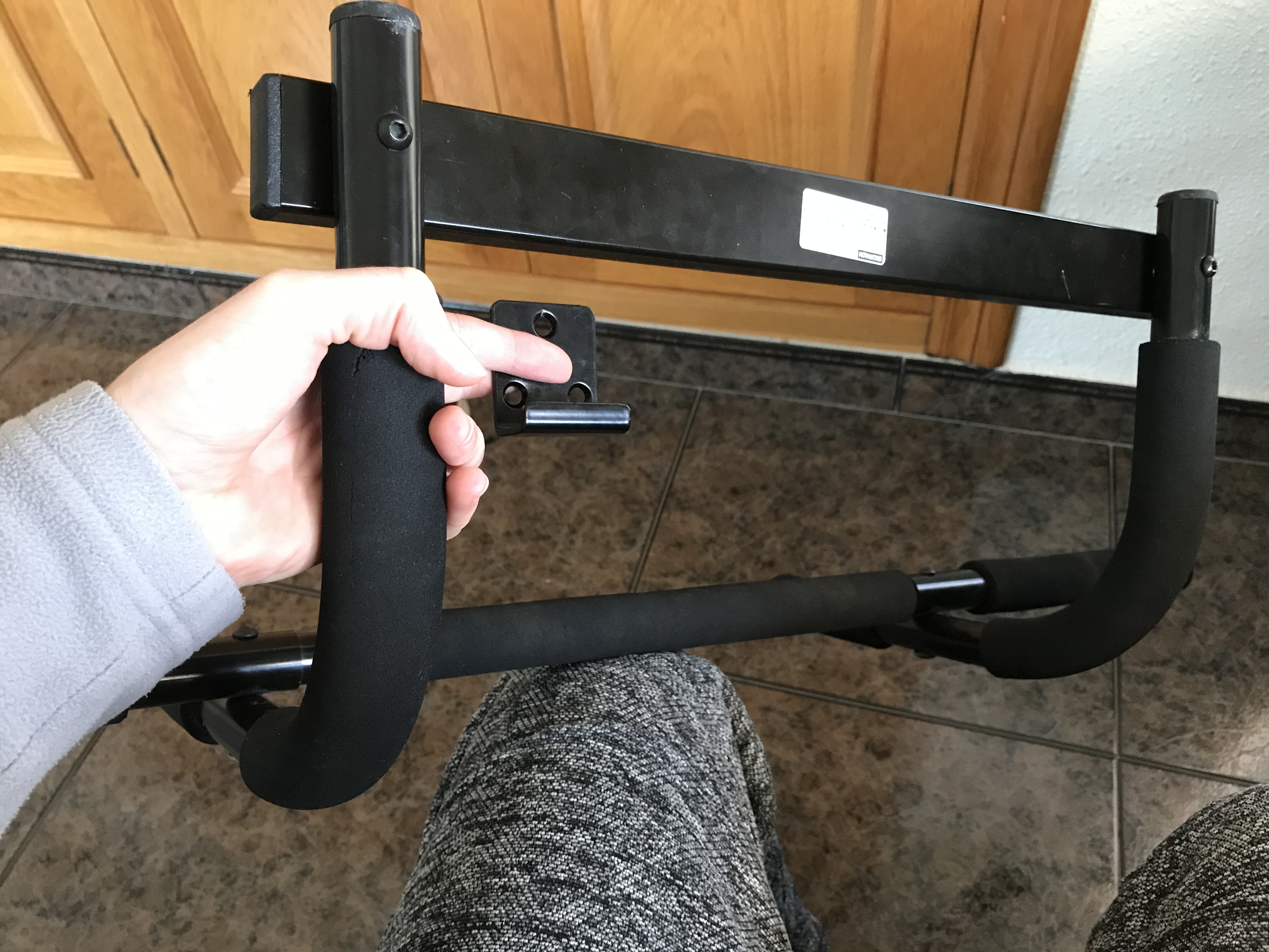

      Hello everyone, I am doing a university work that I have to deliver before May 15, which consists of reproducing the behavior of a traction bar like the one in the images or in this link https: //www.decathlon. en / en / p / traction-bar-cross-training-muscle-pull-up-bar-500-cm / _ / Rp-142047? mc = 8353820 # zoom = opened. The problem is that this error appears to me and I don't know how to solve it: Solver pivot warnings or errors have been encountered during the solution. This is usually a result of an ill conditioned matrix possibly due to unreasonable material properties, an under constrained model, or contact related issues. Check results carefully.

      Due to company policies, Ansys employees cannot download any attachments. It looks like the rigid body modes of the model aren't constrained sufficiently (i.e. the body can move or rotate as a rigid body without developing any stress or strain). Could you attach an image/ figure showing the various boundary conditions you have applied and what the objective of the analysis is?

      Gracias Sai, el objetivo del análisis es colocar, para esta posición dos fuerzas en los extremos de 650N cada una:

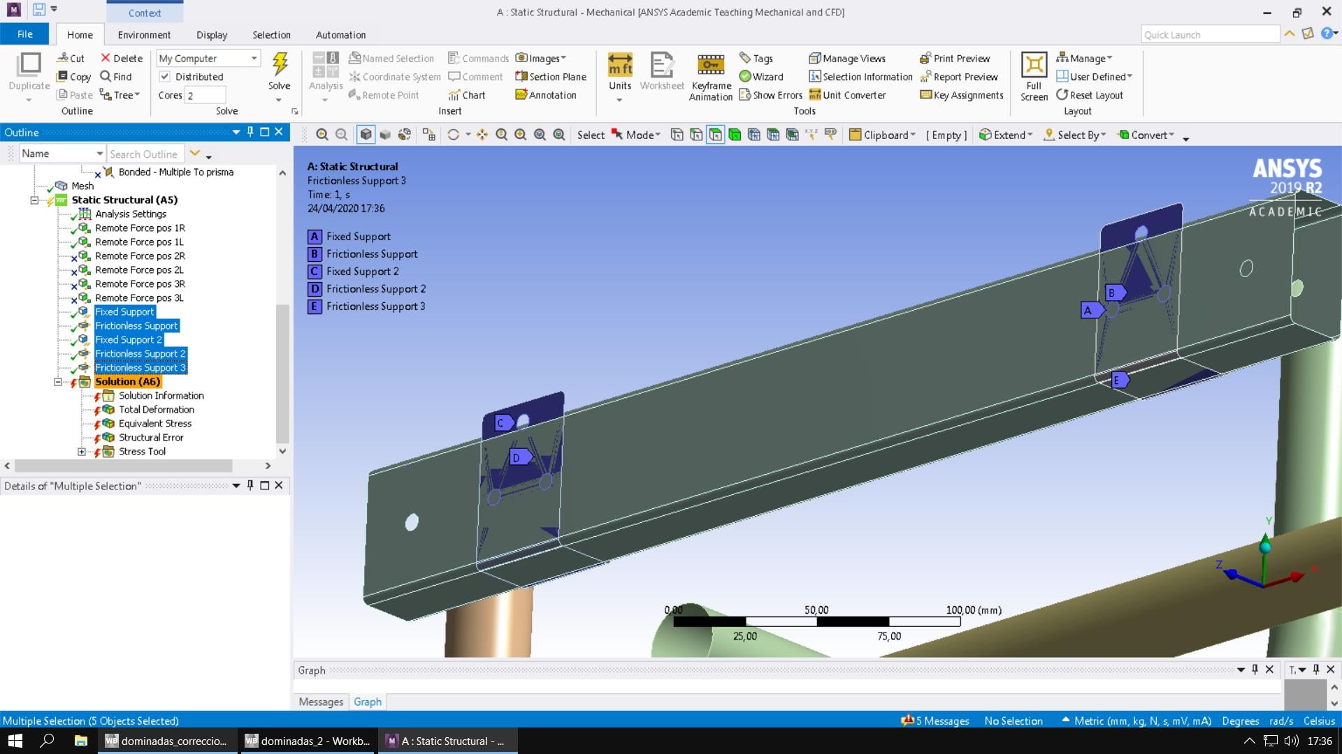

      Respecto a las resctricciones, dado que estoy tratando con superficies, hay un fixed support para los tres orificios de cada soporte, los cuales van atornillados a la pared, y sobre las caras del soporte que está en contacto con la pared un frictionless support para cada soporte:

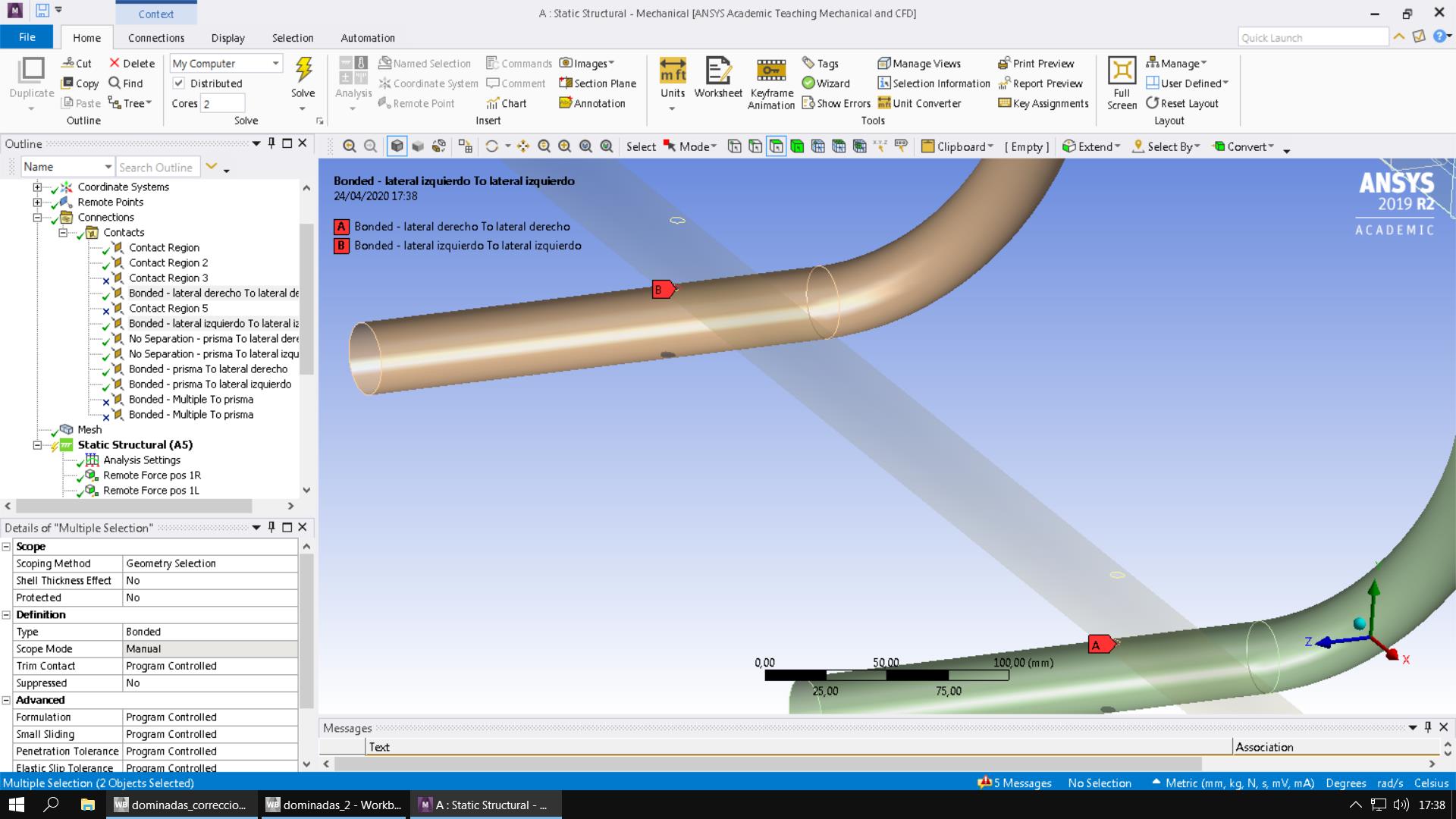

      Y en cuanto a as uniones:
