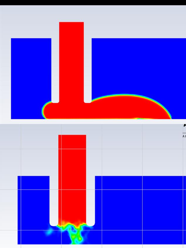

      I, as a completely new guy to Ansys, started building up a model in fluent to simulate the slurry (fluid) deposition through an extruder. First I started to get to know the software via the tutorials in VOF modelling and some overall tutorials. Then I started with a 2D-model to try it out in a simplified model. After this gave me some decent results, I started rebuilding this model in 3d with the same parameters. But when I run this, the calculated VOF surface doesn't look realistic at all with a slurry being so vicious. Especially compared to the 2D-model. And next to that it gives the floating-point error after around 40 iterations. In the attachments of this topic, I uploaded one file containing the two summary files of the model. First, the 2D model summary is given, behind that the 3D model summary
      Would be pleased to have someone that could look at it and give me some tips on what to do next to get some valid results.

      as an Ansys employee I do not download attachments. Slow settling or no settling slurries can be modeled as non Newtonian fluid. If you require sir as surrounding then simple two phase flow with the slurry with adjusted properties and non Newtonian viscosity

      that was general hint without looking into your particular case. Add some more information regarding your 3d problem

      The 3D model now consists of a nozzle at a fixed distance above a substrate. The substrate is moving in one direction to model the slurry deposition during printing. To test the model, the slurry now just has a fixed viscosity of 1 pas/s, this will later be changed to a non Newtonian viscosity.
      As a time step I use a function that changes the time step per iteration: IF(iter<=600, 1 *10**-(10-iter*0.01), 0.0001 ) with a total of 1700 iterations.

      What is now the problem?
    • GuusWezel
      Dear Amine,
      The problem is that the results of the 2D and 3D models are very different. Where the 2D model gives a realistic flow of the slurry, the 3D model does not give a realistic flow at all. This is shown in the figure below.
      Model results of the 2D model (on top) and the 3D model (below)
      Since the input parameters for both models are the same, I can't locate the problem within the model.
      Sincerely,
      Guus
