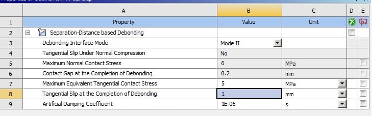

 For the above mentioned Mode-II CZM,in Ansys workbench the required input values are as following,
 1. "Maximum Equivalent Tangential Contact Stress (say in MPa)" From here-on mentioned as C3.
 2. "Tangential Slip at the Completion of Debonding (say in mm)" From here-on mentioned as C4.
 3. "Artificial Damping Coefficient" (say in sec) From here-on mentioned as C5.

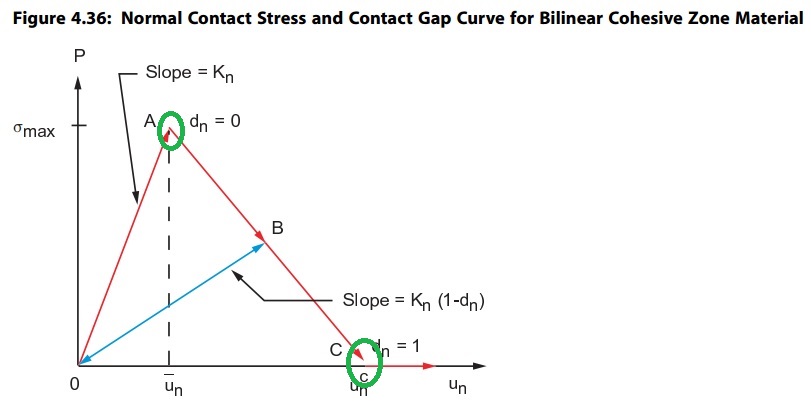

 I checked the Ansys theoretical manual and from the manual the above mentioned input parameters (C3 and C4) are marked as green circles in the graph below. (for discussion let's call it Fig#1)

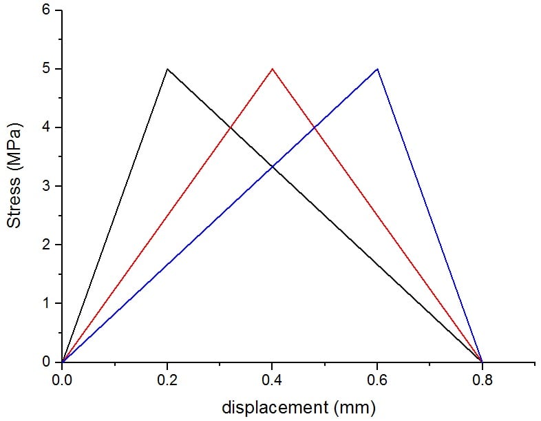

 (a). If I input the above mentioned parameters for CZM (i.e. C3,C4,C5) then how does the Ansys solver differentiates between the following curves? The values for the following curves are imaginary which I made up to ask my confusion. In the curves below, all of the curves have same C3 and C4 values but the corresponding displacement or slip value of C3 are different. Noting that in Mode-II CZM we can only input the C3 and C4 and not the corresponding slip of C3. (for discussion let's call it Fig#2)

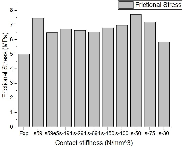

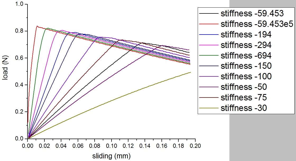

 I ran the simulation with different values of stiffness but with the same CZM input values (C3,C4 and C5) and with same analysis settings and boundary conditions. I recorded the force reaction, slip and frictional stress, and plotted the results as shown below, (for discussion let's call it Fig#3 & Fig#4)
 (b-i) why with the lower stiffness values, the load is also decreasing provided I did not change the CZM input values?
 (b-ii) Shouldn't be with the same C3 and C4 values and with different stiffness I shall get the curve as shown in previous image above Fig#2?
 (b-iii) Could someone please specify the issue and guide me how could I get the resultant values so that the hypothesis/theory mentioned above for Fig#2 could be verified/checked in Ansys simulation.
 your Fig#2 represent the relation between the contact bond stress & Slip and you are asking about the force vs stiffness Fig#3
 Regarding fig#3 the following equation is used by ansys for "Pure penalty" when CZM is used (Mode II - Pure Tangential force)
 F (Tangential) = K (Tangential) * X (Sliding)
 Where:
 F: Contact Force
 K: Contact Stiffness
 X: Sliding Distance (Slip)
 Based on the above equation if you are fixing the sliding distance (Tangential slip at the completion of debonding-C4) and decreasing the tangential stiffness (not directly but by decreasing the normal Stiffness FKN). then the bond/contact resisting force will absolutely decrease as shown in fig#3 and also this is common sense because if for example a lower stiffness adhesive is used as a glue between two materials then absolutely you will get a lower debonding force than if a higher stiffness adhesive is used giving that you assign them the same CZM input values (Bond stress & Slip).
 Your fig#2 (Bond Stress vs Slip) is also valid as you are fixing the CZM material properties and changing the stiffness (Slope).

 The Question is why you are getting different bond stress values with different stiffness values (fig.#4) if you already said that you fixed the CZM material properties (Debonding Failure Criteria) i.e. the bond stress & the slip in the engineering data? maybe mesh refinement (parametric study) is needed as said by SK_Cheah.

 for question (a): the input data for CZM are the maximum normal (or tangential) stress and the maximum gap (or slip). when you input the recommended values the gap (or slip) corresponding to maximum normal (or tangential) stress will be calculated by default, by considering the maximum gap (or slip) equal to six times the gap (or slip) when normal (or tangential) stress reach their maximum value.
 Contact gap at the completion of debonding = 6 * the contact gap at the maximum normal stress
 Tangential slip at the completion of debonding = 6 * the tangential slip at the maximum tangential stress
January 31, 2019 at 12:18 pmjackhero SubscriberDear Amin,
 I used mode II debonding for which I need to input three parameters namely, maximum equivalent tangential stress, slip at debonding and damping coefficient. I manually entered the parameters from the experimental results for both stress and slip. I am not sure about the relations which you have mentioned in your post. as the experimental results were input directly and may not follow the relation mentioned above.
