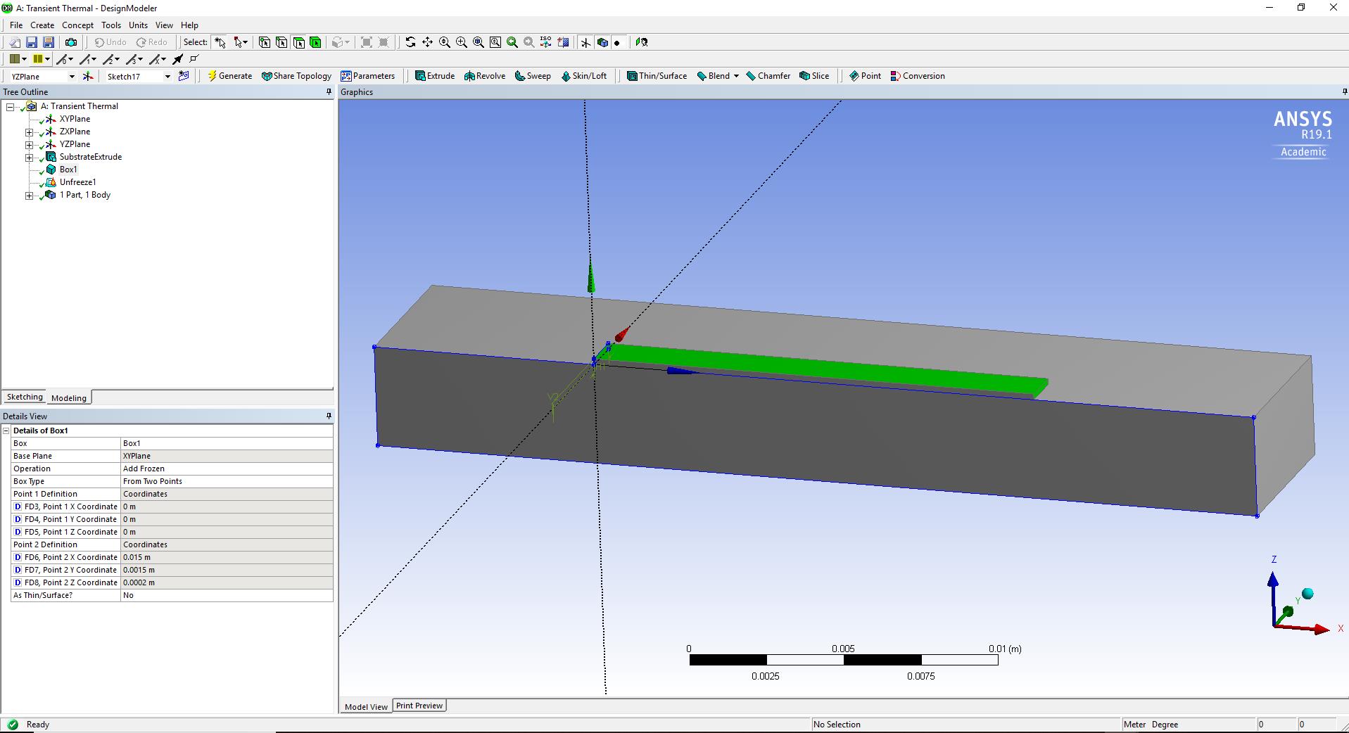

Kellen.traxel
What is the most efficient way to model the laser heat source moving across my symmetric, 3D, single-layer track? I have read about using commands in APDL, however, it is not clear how I can manipulate a nodal (or volume) heat source as a function of the simulation time and position. In the image above, I was able to model a nodal heat source at the starting location (t=0) using APDL commands in the "Transient Thermal" section of my model tree. Ultimately, my question is about the relation between the APDL commands in workbench (and their location in the model tree) and the actual simulation time, and how they could be combined using a DOWHILE loop of some sort so that the local laser coordinates can translate with respect to the overall model domain. I currently do not have access to the ACT toolbox or AdditivePrint in my ANSYS Mechanical license.
Thanks in advance for any information or resources.
Kellen

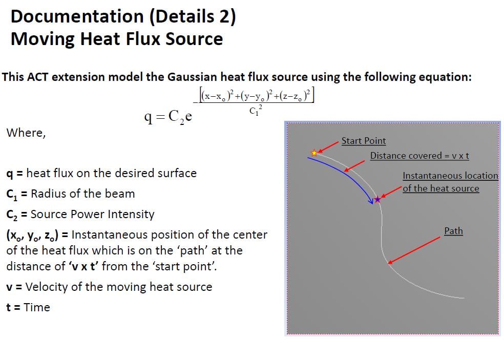

July 19, 2018 at 4:14 pm
Sandeep Medikonda
Ansys EmployeeHi Kellen,
 In general, we have an ACT extension (Moving Heat Source v4.1) that does this in the app store which would be the easiest way to go about this. Now the 1-D example that jpasquerell refers to is shown below and in your case, you would need to extend this to a 2d table which includes both time and coordinate variation.

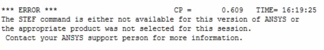

Kellen.traxel

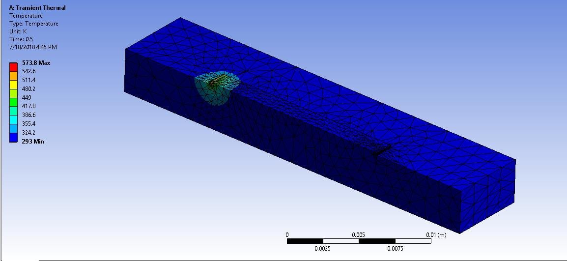

SubscriberThanks Sandeep. I just got access to the ACT so I have been trying to use the Moving Heat Source extension (I am running ANSYS 19.1). I keep running into issues in the provided code such as that shown in the attached image (from the solution information output). I am using some of the main input parameters for the moving heat source, so I am wondering if you have any suggestions for working with the plugin, or if there is a much depeer issue going on. Perhaps you might have some strategies or best practices for debugging issues such as these. Seems like there are lots of "warnings" that occur when using this plugin.
Warm regards,
Kellen

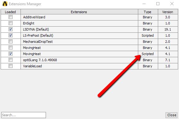

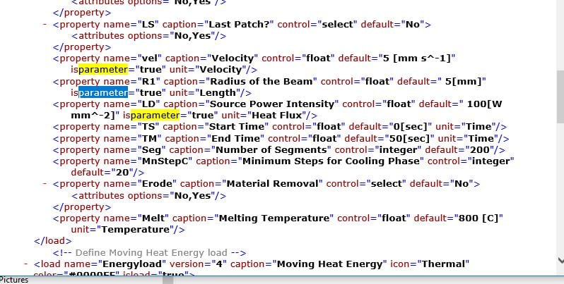

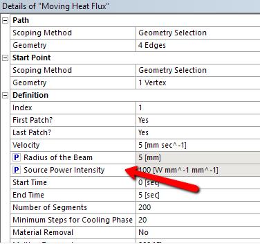

July 22, 2018 at 8:43 pm
Sandeep Medikonda
Ansys EmployeeKellen,
The ACT extension does mention that it supports version 17.0, 17.1 and 17.2. I believe that this could be the problem.
I will reach out and see if there is a solution to fix this.
Sandeep
July 23, 2018 at 4:26 pm
Sandeep Medikonda
Ansys EmployeeHello Kellen,
I've just confirmed that the error is nothing to do with an incompatible version of ACT extension. This act extension also contains source code so you can load it in any ANSYS version without any issue. Â Now, regarding this error, try to check the max end time on the last moving heat definition is more than 'Path length/Velocity'. It could be the highest next whole integer and make sure 'Step End Time' under Analysis setting is more than the highest 'End Time' defined in 'Moving heat flux'.
Let me know if that helped? Â
~Sandeep

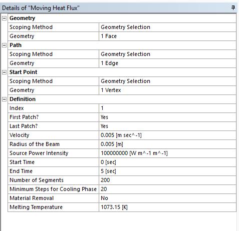

July 23, 2018 at 5:06 pm

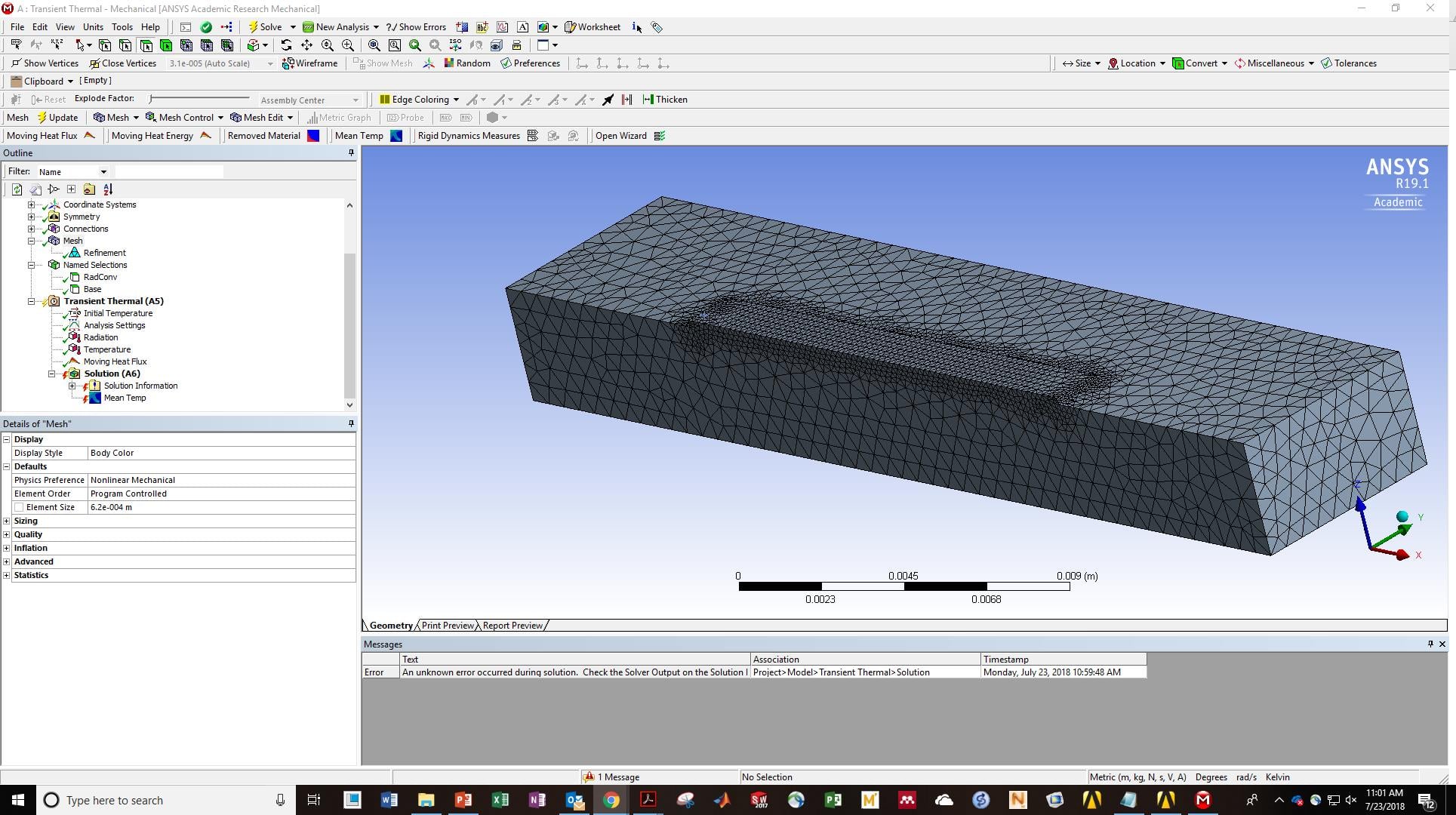

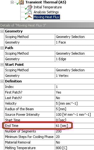

Kellen.traxel

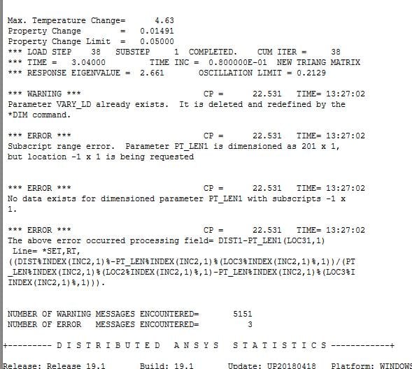

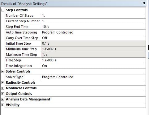

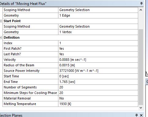

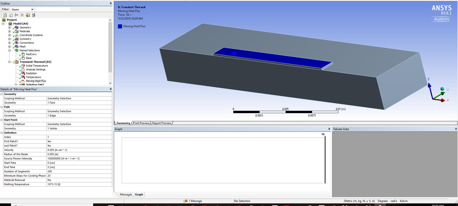

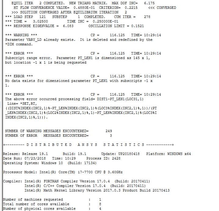

SubscriberHi Sandeep, I believe I had the proper settings for the heat source (See attached output information). I get a few warning messages but no errors, however, I get an error message that occurs during running and then there is no output.
Solver Output
 ANSYS Academic Research Mechanical              Â

 Use Full Nonlinear Thermal Transient Solution
 NLHIST: ADDED NODAL RESULTS HISTORY FOR:
      NAME = MAX_TEMP                      Â
 ITEM/COMP = TEMPMAX
      NODE =        0
      NAME = MIN_TEMP                      Â
 ITEM/COMP = TEMPMIN
      NODE =        0
 ********* Initial Time Increment Check And Fourier Modulus *********
 Specified Initial Time Increment: 0.1
 Estimated Increment Needed, le*le/alpha, Body 1: 0.112461
 Estimated Increment Needed, le*le/alpha, Body 2: 0.00316329
 ******************* SOLVE FOR LS 1 OF 1 ****************
 SPECIFIED CONSTRAINT TEMP FOR PICKED NODES
 SET ACCORDING TO TABLE PARAMETER = _LOADVARI64
 SET ACCORDING TO TABLE PARAMETER = _LOADVARI44
 USE AUTOMATIC TIME STEPPING THIS LOAD STEP
 USE    100 SUBSTEPS INITIALLY THIS LOAD STEP FOR ALL DEGREES OF FREEDOM

July 23, 2018 at 5:25 pm
Sandeep Medikonda
 It looks like you might not have set the 'Last patch ' correctly. If there is only one moving heat load then 'first patch' and 'last patch' are both yes
 If this doesn't help, can you post some snapshots of your setting and attach the complete log file?
~Sandeep
July 23, 2018 at 5:32 pm
July 23, 2018 at 5:34 pm
July 23, 2018 at 5:50 pm
Sandeep Medikonda
Ansys EmployeeKellen, can you post a snapshot of the length of the path (edge) and also the mesh plot?
July 23, 2018 at 6:03 pm
July 23, 2018 at 6:34 pm
Sandeep Medikonda
Ansys EmployeeKellen, Can you put 3sec as end time for moving heat source and try to solve it?
July 23, 2018 at 7:02 pm
Kellen.traxel
SubscriberProgram running now, pretty slow so I will let you know when it finishes.
Thanks
Kellen
July 23, 2018 at 7:38 pm
Sandeep Medikonda
Ansys EmployeeOk Awesome, The speed could be because you do have a fine mesh or it could be the machine too. To speed it up you can change the 'number of segments' but it would reduce accuracy.
July 23, 2018 at 8:11 pm
Sandeep Medikonda
Ansys EmployeeAdditionally, the reason it ran is that your End Time was way off 5 sec. Now, the path you specified is 0.015 m long and the velocity is 0.005, so it would take 3 sec. Now, in cases where it would take 2.7 sec then round it off and make it 3 seconds.
July 24, 2018 at 12:42 am
Kellen.traxel
SubscriberGot it to run. So I basically need to make sure that my end time is close to the actual travel time? Also, does the moving heat source utilize a "quiet" or birth and death technique so that there isn't conduction through "unprinted" material?
Thanks
Kellen
July 24, 2018 at 11:44 am
Sandeep Medikonda
 Yes, it needs to be close to the time you are specifying in the Moving Heat Flux. I saw some EKILL commands being used in the code, so it's probably the birth-death technique. If you are interested, you should be able to access all of the APDL (+ python) code in the act extension:
~ACT_MovingHeat_R170_v4.1MovingHeatsrcMovingHeat

Ansys EmployeeKellen, what version of the ACT extension are you using?
August 12, 2018 at 1:11 am
Kellen.traxel
SubscriberSandeep, I believe it is called 4.1, but it is definitely the one that pops up in the ACT store. Hope that helps.
Thanks
Kellen

SubscriberHi Sandeep, yes I have this documentation. Thank you it helps. How should I define C2? Power/laserarea, as I mention above? Also, for a symmetric BC should I use half of the laser area in the flux definition vs. the whole area? Thanks Kellen -
August 13, 2018 at 3:43 pm
Sandeep Medikonda
Ansys EmployeeYes, I believe C2 is defined by Power/LaserArea.
I don't quite understand your question with respect to symmetric B.C. Is your laser path being affected by the symmetric b.c?
If so, wouldn't the overall path covered by the laser be smaller? Why would the laser intensity have to change for this?
~Sandeep

Sandeep Medikonda
Ansys EmployeeKellen, I misquoted earlier here today, please see my edited response below:
[EDITED]:
I would recommend you to make sure that you are capturing half the area? So yes, it would be Power/(0.5*pi*radius^2). When you make it symmetric on the exact edge, you are modeling 2 lasers with a smaller radius, but we still want to capture the total area captured by the whole laser?
I would recommend you to try 2 test cases to confirm if you are getting similar results, One with the full body and one with the symmetric condition defined on the edge? Is this possible?

August 13, 2018 at 4:35 pm
Sandeep Medikonda
Ansys EmployeeAlso,
With regards to parametrizing a variable just open the xml file (in the folder ~CT_MovingHeat_R170_v4.1MovingHeatsrc) and for the input you want to parametrize just add isparameter="true".
Sandeep
Do I need to reinstall ANSYS or do anything additional for the parameterization to work? I input that line of code into the correct folder and am not seeing the parameterization checkbox.
Any info helps, as always.

Sandeep Medikonda
Ansys EmployeeKellen, can you try uninstalling from the ACT start Page and re-install that extension again?
August 13, 2018 at 11:16 pm
Kellen.traxel
SubscriberI did, it did not work. One thing that might not be right is that I have stored the extension in the same folder as my ansys results files. Should the extension (.webex) be saved in the same folder as the ANSYS program is saved?
Kellen
August 14, 2018 at 1:42 am
Kellen.traxel
SubscriberHi Sandeep, another question I have about residual stress analysis is there a simple way to incorporate annealing of Ti6Al4V (i.e. when the annealing temperature is reached, displacement is equal to 0)?
Thanks as always,
Kellen
August 14, 2018 at 2:07 am
Sandeep Medikonda
I will have to debug a little w.r.t parametrizing the model. I will keep you posted as I find out.
For Annealing, please try EKILL/EALIVE. There are numerous discussions in the forum on this. Try and include a blank load step after EKILL and use EALIVE. Please see this article and this discussion on XANSYS.
P.S: If you have found a solution to your initial query, please mark it as a solution (even if it is your own post) so that it would make things easier for someone going through it at a later time. Also, please post new questions as a new discussion and provide a link to the old discussion.
Sandeep
August 14, 2018 at 1:24 pm
Sandeep Medikonda
Here's what you do to get it to work:
1. Add the isparameter to the variable of interest in the xml file (recommend you to do this in the original download). In this case, I selected Radius and the Source Power Intensity:
2. Next, copy that file MovingHeat.xml and the folder MovingHeat found in the src folder toÂ
%appdata%ansysv191ACTextensions
Replace anything there although I think you would need just the xml file placed there.
3. Once you re-launch Workbench, select the Scripted MovingHeat extension instead of the Binary one.
4. Now once you re-launch Workbench, you will observe the parameter buttons appear:
Hope this helps.
Sandeep
August 14, 2018 at 2:44 pm
Kellen.traxel
SubscriberHi Sandeep, it worked!
Thanks and I will post on a new discussion when I have further questions.

SubscriberHi Sandeep, I am having a VREAD error when also using MovingHeat. I was wondering if you would be able to assist me with this?
May 19, 2019 at 6:43 am
Karldekruyf
SubscriberI have installed the MovingHeat extension as per the instructions above, and have established my model using the included MovingHeat_help.pdf file. When I attempt to solve my model a VREAD error occurs when the solver is accessing the velocity array. What would be the best way to resolve this?

April 23, 2020 at 7:53 pm
sunil.voleti
Subscriberhai kellen,
I am simulating laser like you with extension could you please explain me how did you defined Absorption rate or absorption coefficient for simulation.
Thanks in advance.
April 23, 2020 at 7:56 pm
sunil.voleti
SubscriberHi sandeep could you please expalin me how we can define absorption rate or absorption coefficient when I am using moving heat source(moving heatflux) extension for my simulations.
Thanks in advance
April 23, 2020 at 8:21 pm
Kellen.traxel
SubscriberHi Sunil, simply multiply the overall heat flux (you calculated based on laser parameters and instructions within the toolbox .ppt itself) by the absorption coefficient (found in the literature depending on the material). Then input this value into the ANSYS toolbox instead of the value calculated without taking into account the absorption ratio.
Best,
Kellen
April 29, 2020 at 9:45 am
sunil.voleti
SubscriberHi Kellen,
Thanks for your answer. could you please explain me in detail about your last answer how we can input absorption rate in moving heatsource extension (moving heatflux) in ansys. and can you please also explainÂ
In transient thermal analysis there is option to select Tabular data for convection which is already defined with in the application with this equationÂq/A =Âh(t s -Ât f) ,I would like to know what is the film coefficient (h) used by ansys for this convection tabular data.Or else could you please explain how did you calculated film coefficient for your simulations.
Thanks and Regards,
sunil.voleti. -

September 12, 2021 at 2:44 pm
Alp
Subscriber.Hi,
what if one wants to simulate it for 60 second while using the same parameter? For instance, heat source will travel the same path untill the 60 sec is over. Heat source in this case will travel the same path over many times to complete the 60 sec. So what do you think about it? How the parameters should be changed to adapt this situation?
BR,
Alp.
