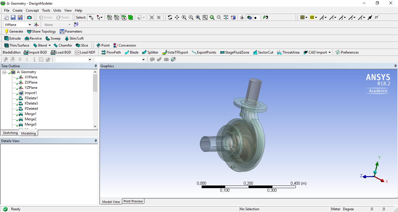

      I'm doing my final degree work on centrifugal pumps. I have to obtain the characteristic curves of a specific centrifugal pump (I have it in .step format). I've been doing this for several months but I can not get a well-structured mesh. I am trying to mesh the fluid zone by dividing it into two parts, one in which the impeller (rotation zone) is included. How can I meshing that zone of rotation? I can not separate it into simpler bodies

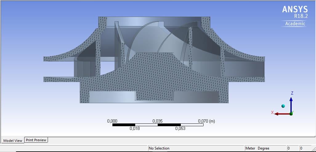

      Thank you peteroznewman and Raef.Kobeissi for your advice, I followed the instructions of the Raef tutorial applied to my pump but I have problems with the mesh, that is, it does not have good values of skewness, orthogonal quality and aspect ratio. How can I solve these problems? Because of this the solution does not converge or does not have results close to the reality that I would like to obtain. Attached capture of the mesh where the size of my pump is seen and I attach the files of my project. I hope you can help me.

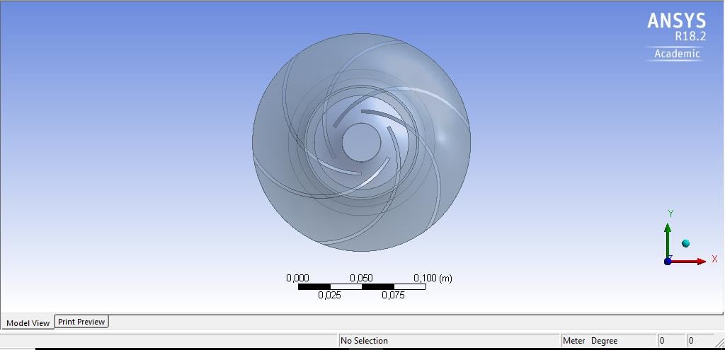

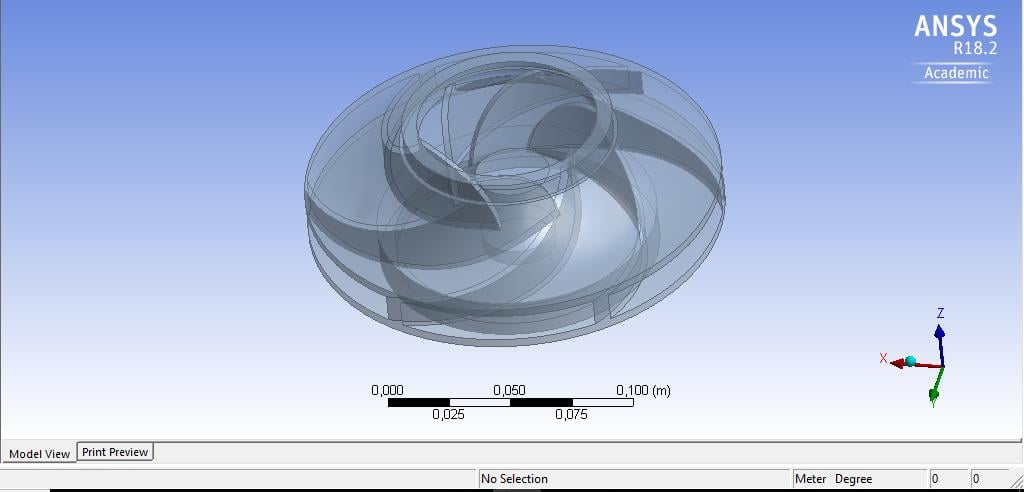

      I know I know and I saw your video before, the problem is that my impeller is a bit complicated, I explain you below.
      I have this impeller
      And I get the fluid zone doing a boolean with impeller and impeller zone
      What I can't do is split that fluid zone into a multibody part and get a structured mesh with hexahedrons.

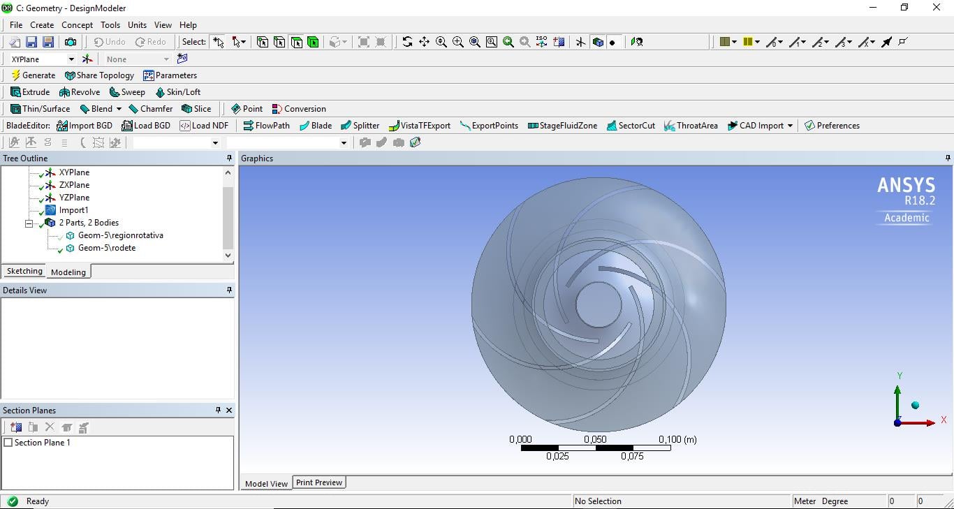

      I made some progress since the last time I wrote you I am working with a 60 degree sector of the impeller zone as a multibody part,
      but when I do a part of multiple bodies sweppable bodies dissapers and I can't mesh it.
      Attached update files
      Fran
      Hi Fran, here is a video for you based on the attachment above.  You brought DM geometry into SC, then back into DM again. I found that hurt the ability to slice the geometry so I built this off the original DM system, not the last DM system. Next video to make is the actual meshing.
