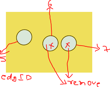

      Suppose I have a model like this
      Whose edge IDs are 5,6,7
      suppose i want to remove the region inside edge 6 and edge 7.
      If i use the GUI i would go to Design->Split Body and select edge 6 and click on the region marked as 'X' in the above figure.
      Suppose i want to do that with python script how can i do this?

      suppose i want to just run the code and delete the region of circle 7 i don't think this will work because i don't know the following information
      which edge to pick and which region of the edge do i pick to delete. So i don't know how to achieve this programmatically using the API. Please let me know how to achieve this?

      I see you are using the Combine tool and seleting a body so edge selection is not involved. The RemoveRegions() method is done as the second part of a Combine operation that intersected some bodies. The is the same as just deleting a body after the intersection. A big challenge with scripting, which determines ultimately whether a process can be scripted or not is whether selections can be done without a graphical interface.
      One way to handle this is to place edge/bodies/faces/vertices into named selections before the script runs, and the script will get entities in the named selections. Another way, which can sometimes get the desired entities in simple models, is to get based on a min/max XYZ value. You can get a bounding box or centroid of faces/edges/bodies and check XYZ values and only use those above or below a value you want. For vertices, you can get exact XYZ locations to check against min/max target values. You already know about the index method for selections, which is a type of selection by ID.

      I have a script that can create named selections for the edges.
      so lets say in the above example itself i create a named selection called group5, group6 and group7
      how would i go about this?
      I have only one body.
      I think this will be a clean process
      1. i will split the body based on the named selection of the edge
      2. Using the two bodies created bodies use the above commands you mentioned to remove the second body
