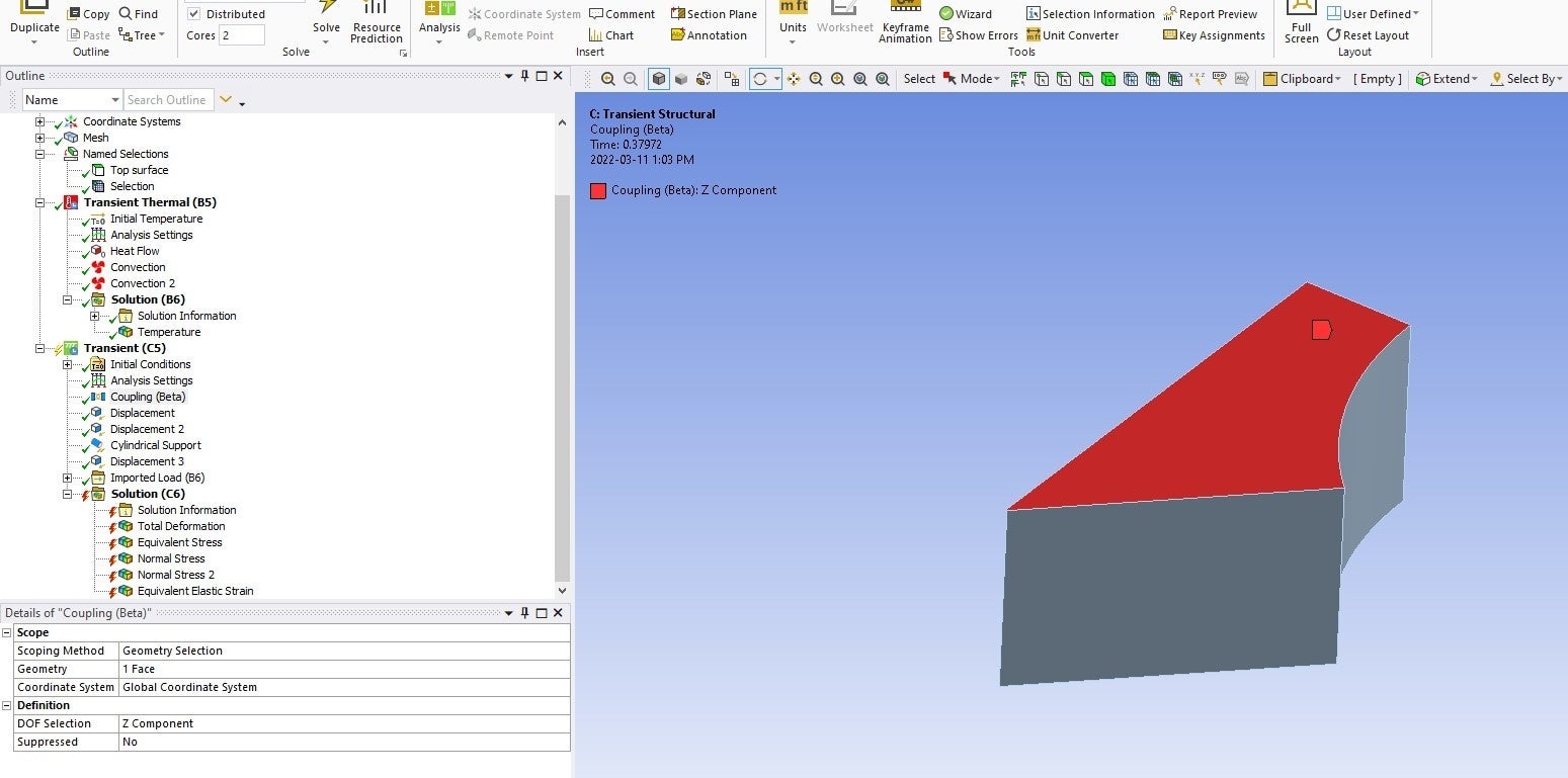

SubscriberI am running a thermomechanical simulation and I have an issue regarding imposing a special boundary condition. I require to apply a constraint on nodes of a plane to allow them only to move together in certain direction (e.g. all nodes should be free to move in z-direction but all the nodes should have the same displacement in that direction). In other words, I require that plane to remain flat and keep the normal constant all the time, although the entire plane can still move . I do not want to fix the plane in that particular direction, but only to constrain the nodes to move together in certain direction. I haven't find a solution to this so far. Any idea how to do it?

Ansys EmployeeThat sounds like using 'Coupling' in either MAPDL or Mechanical. In MAPDL you would use the CP command. In Mechanical Static Structural - Right mouse click- insert - coupling should do it. If the plane is not parallel to the global coordinate system then you can rotate the nodes on that plane to a rotated coordinate system and then couple the Z axis as you want in that coordinate system.

SubscriberThanks for your comment. I used coupling of nodes on the top surface as you can see in the attached file. But it conflicts with other BCs. I have no idea why it should conflict. I have fixed two side planes in the normal direction as they are symmetry planes. They are free to move in z-direction. Do you have any idea why it does conflict with this BCs. Thanks.
