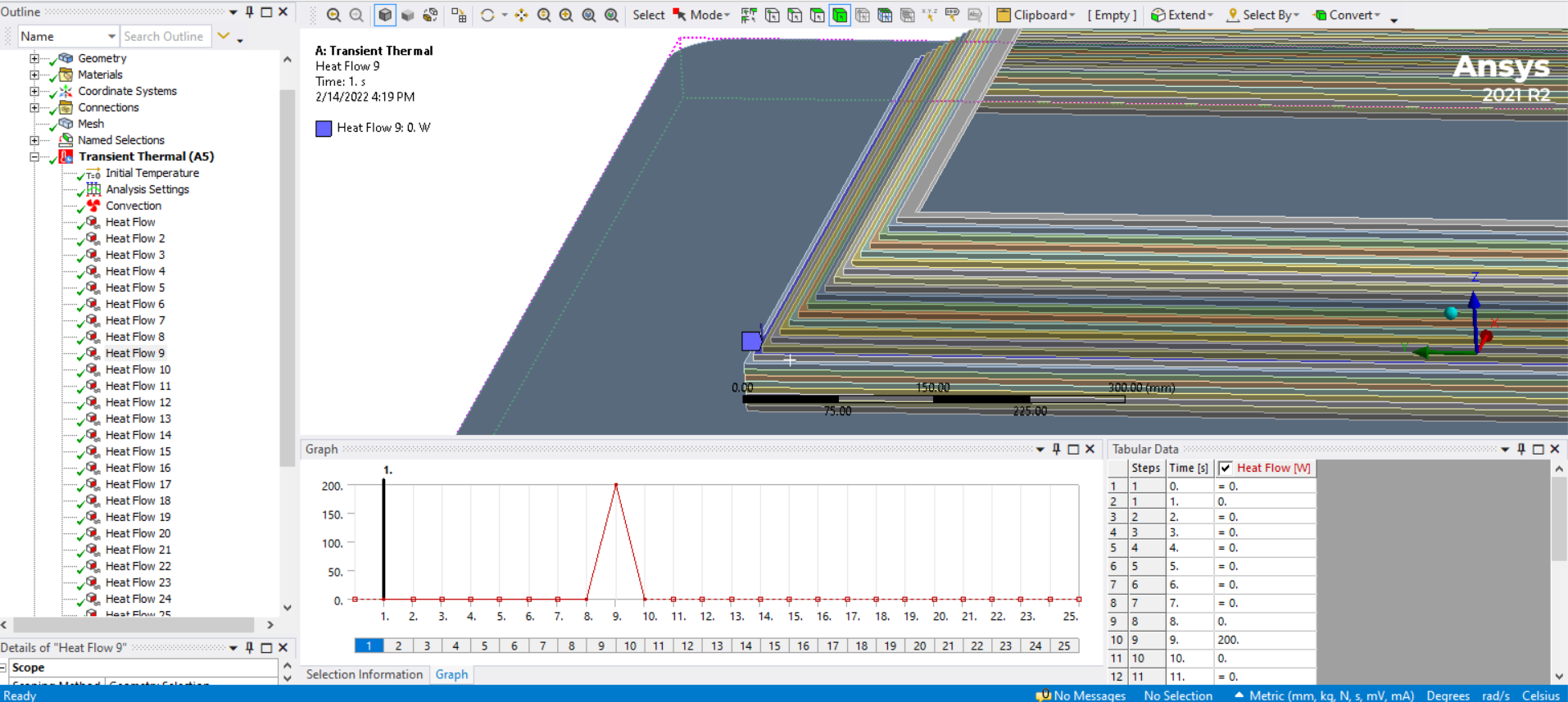

I am working on a FDM 3d printing process and I have this pyramid model which has 25 layers in height(build material). I used 25 time step (each block assigned 1 time step). I added a (Heat flow )Boundary condition of 200 C on every face of the block on corresponding time steps. (For example-I select first block and set it to load step-1 and with Heat flow 200c on the top face and so on)
But when I run this simulation. I get the max and min temperature of around (22 Degree C- 22 Degree C).
Is it my simulation not running.?

February 15, 2022 at 2:15 pmmkalel
Subscriberthanks for the comment but can you please elaborate . I didnÔÇÖt understand
thanks
