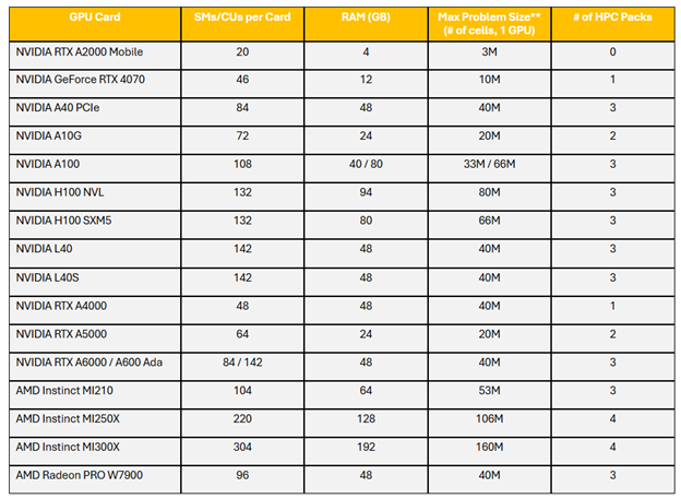

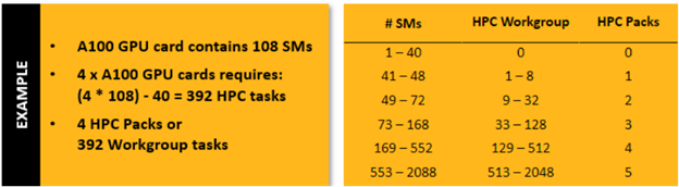

FAQs1. Which license is required to run Fluent on GPUs?
To run Fluent on GPUs, you need a license that provides access to CFD Enterprise capabilities version 2023 R1 and later, or CFD HPC Ultimate starting with 2025 R1 SP2.
With a CFD Enterprise License, licensing is based on the total number of streaming multiprocessors (SMs), if using NVIDIA GPUs, or compute units (CUs) if using AMD GPUs. 40 SMs/CUs are included with the CFD Enterprise license. For additional SMs/CUs, you must purchase Ansys HPC licenses. See the appendix for additional information about SMs/CUs.
HPC Requirements for Common GPUs:
**Assuming 1.2GB GPU RAM per million cells for a typical Single precision Steady State SIMPLE model. Actual GPU RAM requirements per million cells will be case specific and will depend on the mesh type, physics solved, single vs. double precision and other factors. Double precision and the Coupled solver significantly increase RAM requirements. Larger mesh sizes can be solved using multiple GPUs.
Example of HPC Packs required for an NVIDIA A100 GPU Card
When using a CFD HPC Ultimate license, you have access to unlimited SMs/CUs. Contact Us to learn more about this license type.
