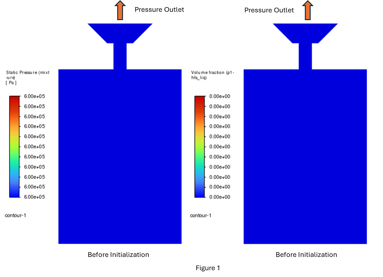

I am a research student and modelling a propellent flash-boiling flow inside a chamber of which only one side is open to atmosphere.
I want to simulate the propellent is initially stored with a liquid volume fraction of propellent (at 6 bar), filling only 1/3 rd part of the chamber. And rest 2/3 rd part of the chamber contains vapour volume fraction of propellent (at 1 bar). To achieve that, I want to patch the liquid volume fraction with the vapour pressure of 6 bar and rest of the part with vapour volume fraction at atmospheric pressure of 1 bar.
But after initialization, the entire chember attains the pressure equal to vapour pressure (i.e., 6 bar, an input value of caviation model for vapour pressure), and the Fluent does not allow to patch my desired 2/3 rd part of the chamber at atmospheric pressure of 1 bar. But, Fluent does allow me to patch the desired volume fraction.
Other Modelling Setup details as follows:
Fluent Version - 2024R2
State - Transient
Models - 3D, VOF, 2-Phase, Schnerr-Sauer caviation model.
Turbulence Model - k-omega SST
Mesh - Hexahedral
Boundary conditions - Only Pressure Outlet with gauge pressure of 1 bar
Material - Propellent liquid and Propellent vapour
Best Regards

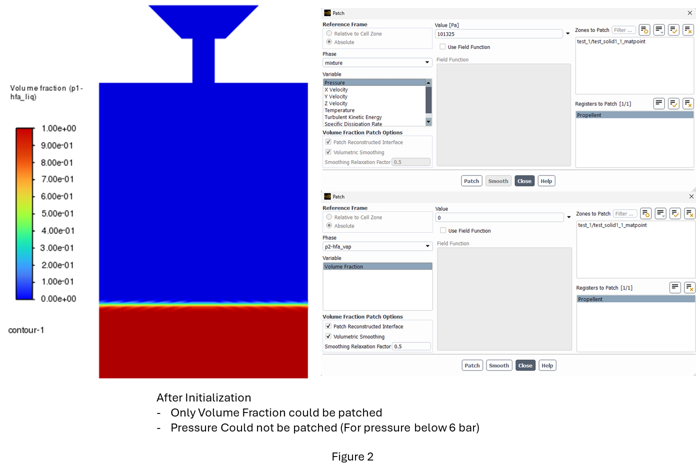

Yes, I agree with your thoughts. But, somehow I am unable to patch pressure at the mixture level.
I am able to patch pressure which is above vapour pressure (greater than 6 bar) of the propellent but not below (lower than 6 bar) of it.
Regards
May 14, 2026 at 3:53 pm
Rob
Forum ModeratorPlease can you post screen shots?Â
May 14, 2026 at 10:41 pm
May 15, 2026 at 8:53 am
Rob
Forum ModeratorInitialise at 1bar and then patch liquid to 6bar. How can you patch the gas region to 1bar when there's not a register? Make sure you save before iterating as I suspect it's not going to be stable.Â

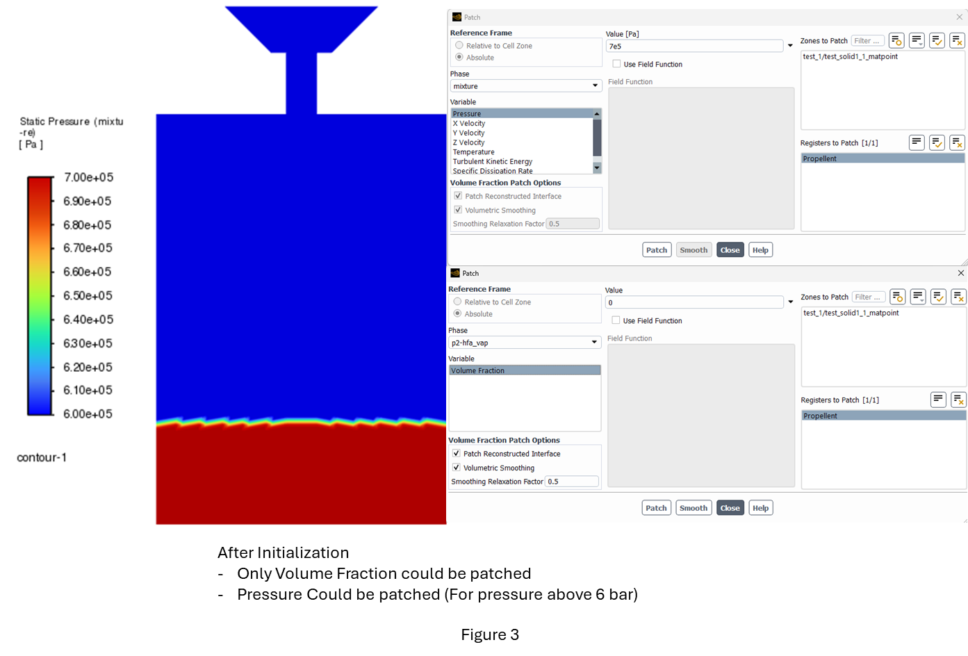

I have already tried changing the initialization (gauge) pressure ranging from -10 bar to 5.99 bar, the setup always gets initialized at 6 bar.
The setup gets initalized to higher pressure (e.g., 6.1 bar and beyond) successfully. But, it fails to get initialized at any lower pressure.
Correct me if I am wrong, these trials are possible with standard initialization, which I have already conducted. The setup is not respecting my initial values for lesser pressure (< 6 bar), it is only respecting for higher values (> 6 bar).
In case of hybrid initialization, the results are the same. The setup always gets initialized at 6 bar (i.e., at vaporization pressure of 6 bar) automatically.

My question would remian the same, why Fluent is not allowing me to patch the lower pressure to the liquid volume fraction when the caviation model is switched on? or Why does the entire fluid domain attain the pressure as vaporization pressure?
Regards
May 18, 2026 at 8:27 am
Rob
Forum ModeratorInitialise as liquid at 1 bar, then patch gas phase & then liquid pressure. I wonder if there's a check so you can't patch a pressure on the domain that's lower than cavitation value. Cavitation wasn't designed to mimic flashing and there are a few hard coded checks in Fluent to prevent impossible set ups: they're not always as sensible as you'd expect.Â
May 20, 2026 at 4:32 pm
abhu123patil
SubscriberDear Rob,
I guess there is a check for patching a pressure on the domain that's lower than cavitation value.
