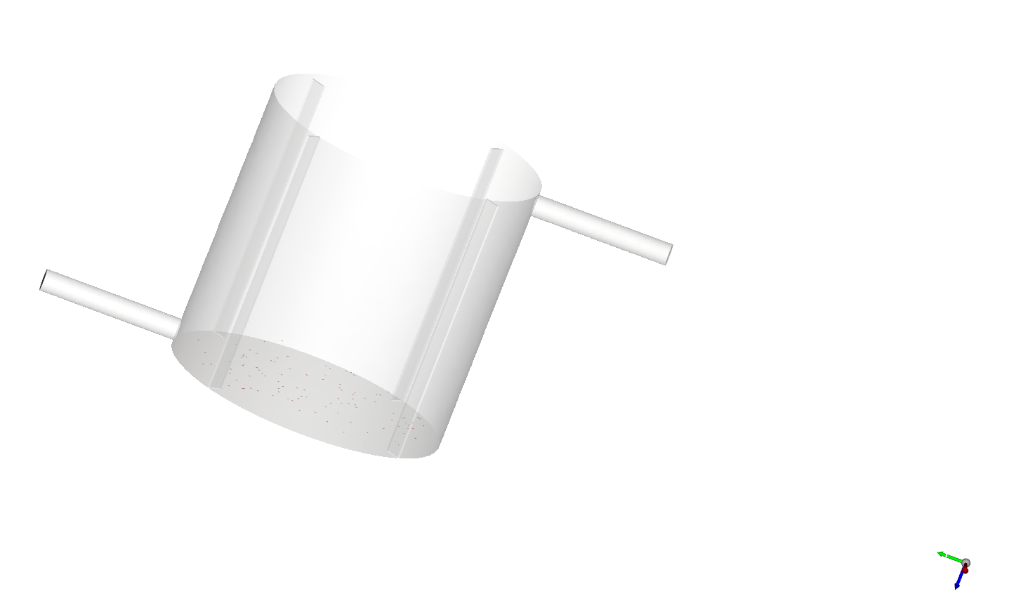

      I have a tank which has these dimensions
      x [-0.7,0.7]
      y[-0.5 0.5]
      z[-0.5 0.5]

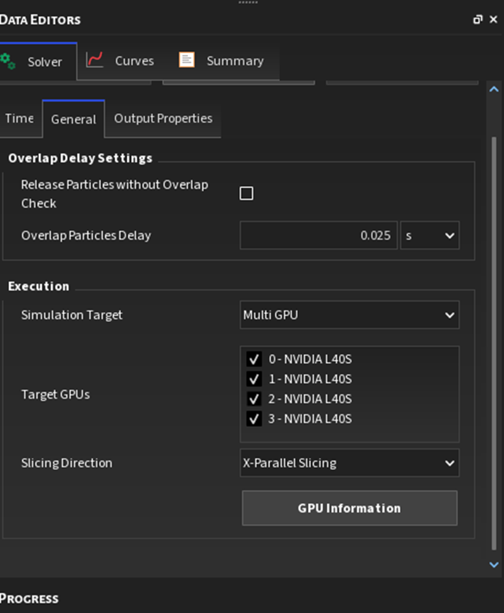

      I am trying to run the simulation with 4gpu and i keep getting error in the simulation. This error is so generic and i dont know why it is causing
      Error:QSocketNotifier: Can only be used with threads started with QThread
      I have given the correct gpu slicing --multi-gpu-slicing-direction=X but still i get this error
      Can anyone suggest why?

      Its a mixing tank of 1m diameter and 1m height. There is a top inlet pipe of  20cm and bottom outet pipe of 20cm in the x direction hence the total distance covered in x direction ranges from negative 0.7m to positive 0.7m. the pipe diameter is 10cm. I have about 700 sphero cylinder particles made of multiple elements (flexible one)

      So this is what i get
      my geometry
      I do the slicing in x direction

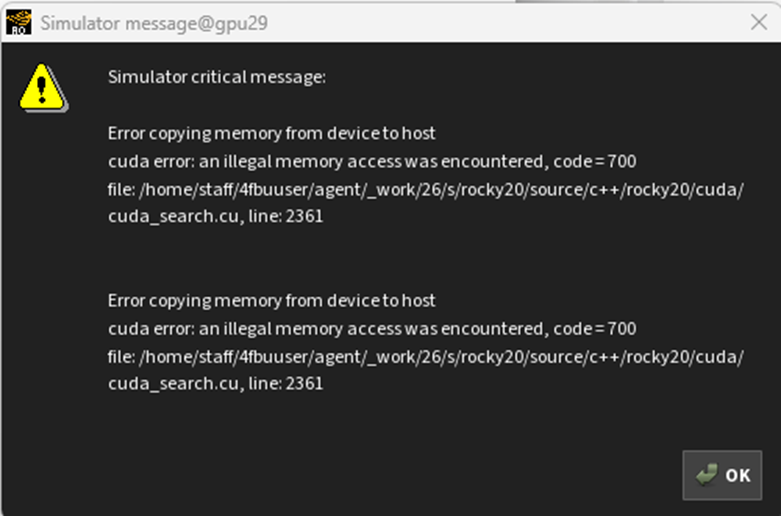

      I get this error

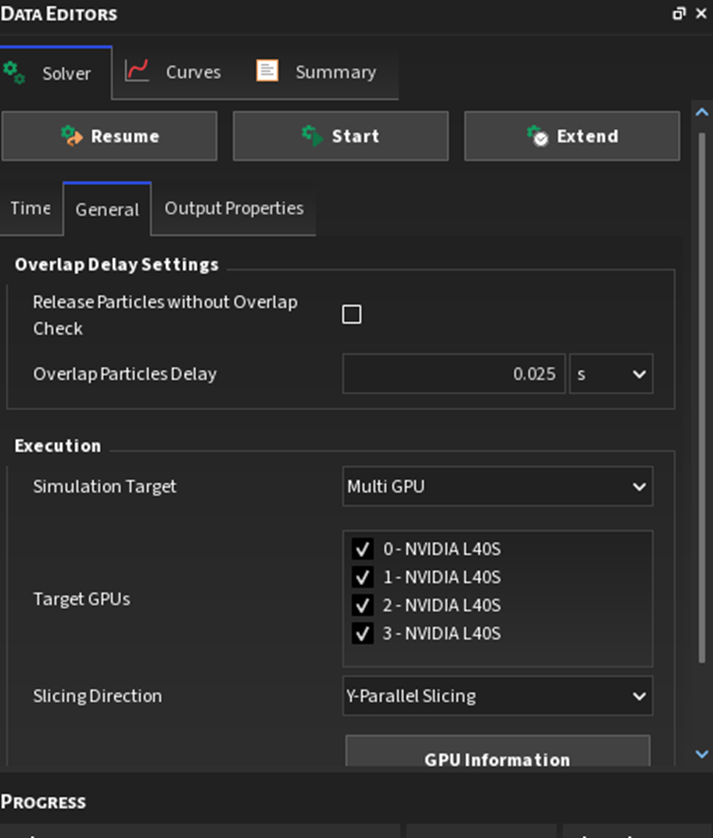

      I do the slicing in y direction

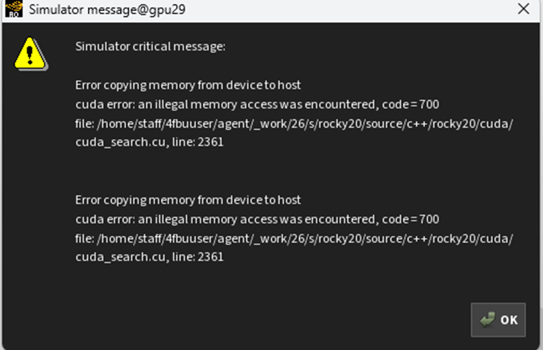

      i get this error
      Please tell me how to fix this

    • Lucas Bertollo Baggio
      Which Rocky version are you using?
    • Shyam Prasad V Atri
      Rocky 2025 r1 (2025.0 academic university version)
      Could you try to reproduce it in Rocky 2025 R2?
      i need to ask for the installation on hpc which may take time. is there any way this version can be used? Because changing versions is a time-consuming and painful process.
      We had a bug with multi GPU that was fixed in 2025 R2. I think that updating Rocky is your best first try!
