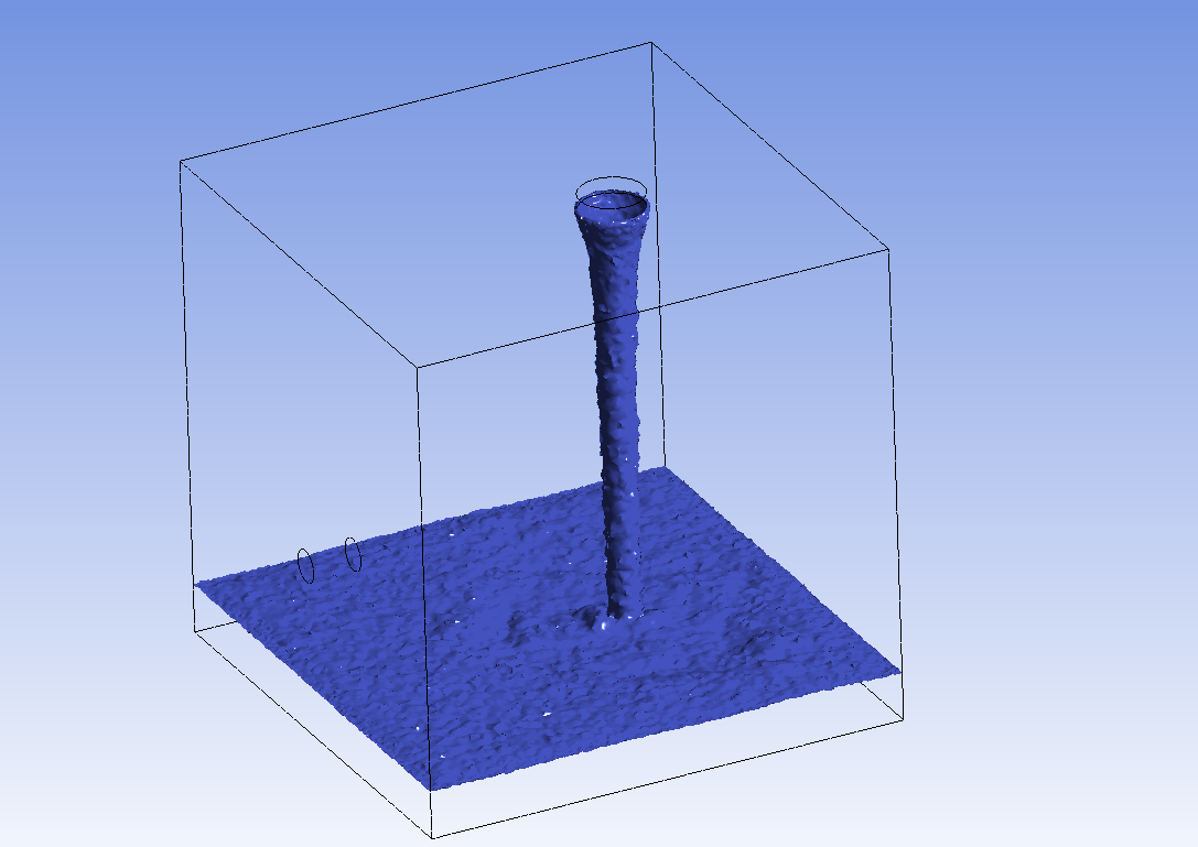

I am simulating pase backfill for a stope in an underground mining environment(air+paste) are my two materials.I am using multiphase transient simulatio.My problem is when I do the animation,I do not have a smooth rise of paste but only shows my the laste fill as seen in the photo above.Please help me out.Also my simulation takes a lot of time to get the result,kindly help. -
March 6, 2026 at 10:19 am
Rob
Forum ModeratorThat looks fine, and the rough iso surface may be a function of mesh. Which solver are you using?
