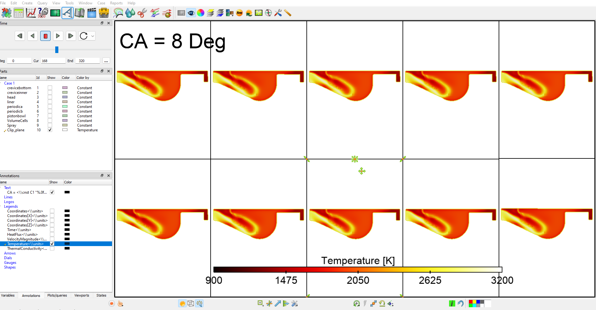

      I am using EnSight 2024 R2 to visualise results from an ANSYS Forte sector mesh simulation. My goal is to display different crank angle (CA) time steps in multiple viewports (e.g., CA = 0°, 10°, 20°, etc.) for side-by-side comparison.
      However, I’ve been unable to find a way to independently control the time step in each viewport. The typical options such as “Time → Lock Viewports” or “Link → Time” (via right-click menu) are no longer available in this version, and methods such as Ctrl + scroll have not resolved the issue. Each viewport remains locked to the same global time.
      I have attached a screenshot showing my current layout, where I wish to assign a different CA to each sub-view.

    • Usman
      Thank you very much for your detailed explanation on how to load multiple cases in EnSight and manage different crank angle views using multiple viewports. Your step-by-step breakdown is greatly appreciated and has helped clarify the general workflow.
      I would be very grateful if you could kindly provide a few illustrative figures or screenshots to visually guide me through the steps, especially for setting viewport visibility and freezing parts at specific time steps.
      Additionally, I was unable to locate the "Active toggle" option in my version of EnSight. Could you please advise where I can find it or how to enable it?
