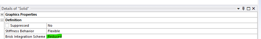

      For a specific postprocessor, we need elements with reduced integration. In Ansys Classic no problem:
      ET,1,SOLID185
      KEYOPT,1,2,1
      But this not work in Ansys Workbench. If I add a command block to my geometry in that way (mesh option linear):
      KEYOPT,typeids(1),2,1
      and I open the RST with Ansys Classic an list the element types, I see:
      ELEMENT TYPE        1 IS SOLID185     3-D 8-NODE STRUCTURAL SOLID
      KEYOPT( 1- 6)=        0      3      0        0      0      0
      KEYOPT( 7-12)=        0      0      0        0      0      0
      KEYOPT(13-18)=        0      0      0        0      0      0
      Keyopt 2 is set to 3 (= Simplified enhanced strain formulation).
      How can I solve this problem? Thanks!

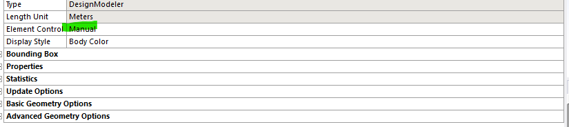

    • ErKo
      Do this natively:
      Element control manual
      (Then set reduced)
      With that we get all good results and reduced int.
      All the best
      Erik
