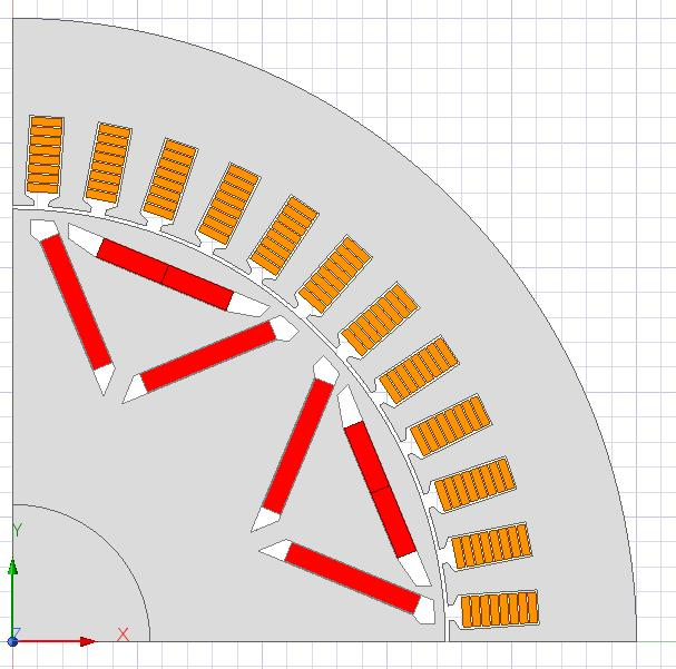

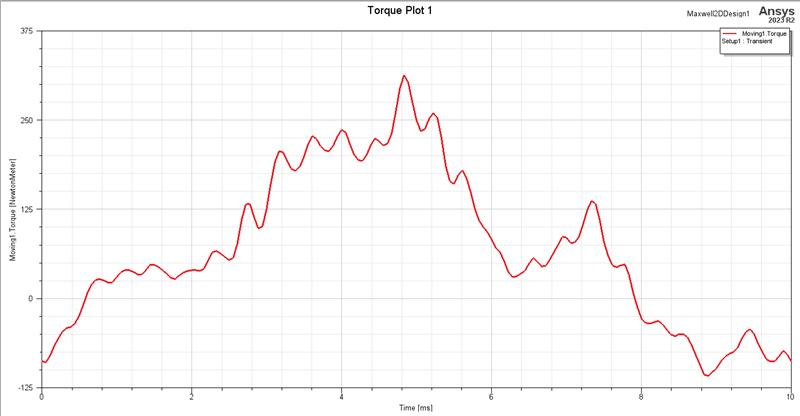

SubscriberI setup the Maxwell 2D Model and when analyzing the model the output of the torque is very unstable and I don't know how to fix it.I am using a two-pole section when importing the geometry (North and South) but can't get a reasonably stable torque output.ÂÂCounter Clockwise, each phase has two slots and the sequence is: A+, C-, B+, A-, C+, B-ÂTorque Output looks like this:ÂThe flux density in the air gap looks like this:I have tried changing phase sequence, coil exitation direction and starting angle but it doesn't seem to be making it any more stable.Any help would be appreciated.
