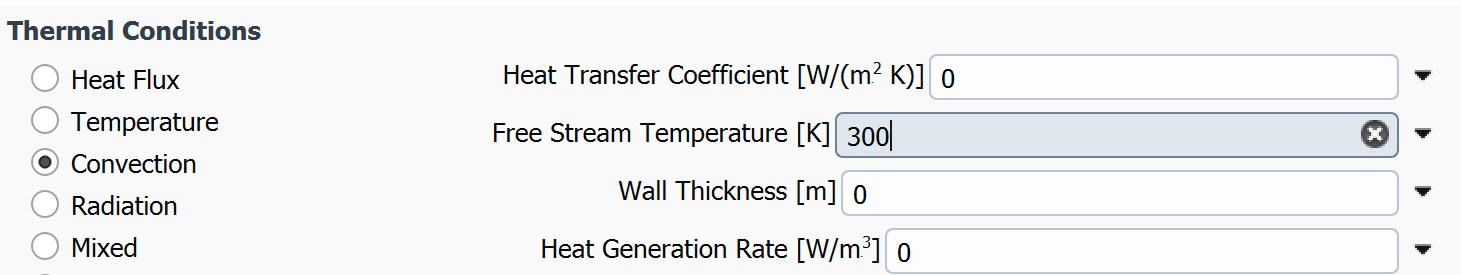

      hi, I want to apply convention boundary condion on a wall as a functin of varing ambient temperature. I have written a udf for free stream temperature (ambient) as funciton of time but it has unexpected effect in the convection boundary condition at the wall. when I am changing the temperature value in the udf it has no effect on solution. but for expression and as constant free stream temperature it works fine.
      I assume you've got DEFINE_PROFILE returning a temperature in Kelvin and hooked into the highlighted box below?
