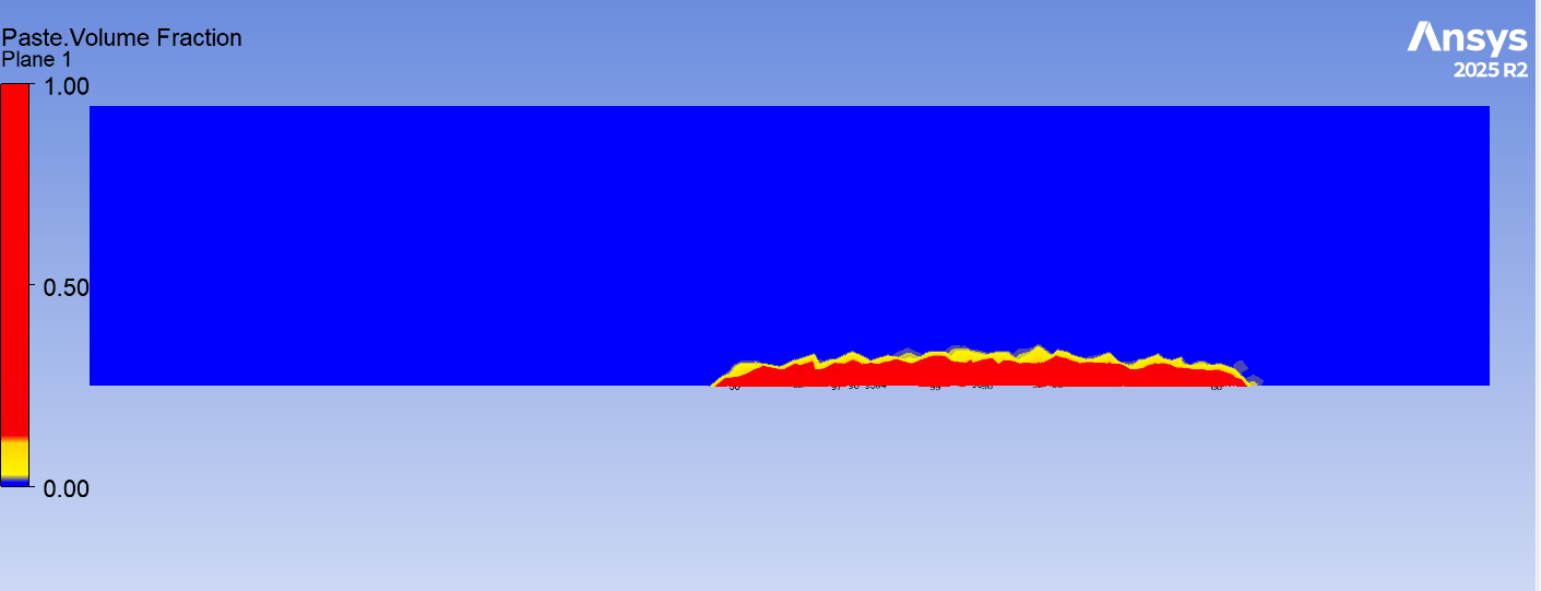

      I am running a multiphase transient simulation where slurry (mixture of water, cement, and tailings) is being discharged in a tunnel through an eight-inch diameter pipe (see the figure below). The geometry represents cut-and-fill mining panel with dimensions of approximately 60 ft (18.3 m) in length, 7.5 ft (2.3 m) in width, and 15 ft (4.6 m) in height. The model incorporates an 8-inch-diameter delivery pipeline installed along the roof with the discharge point 20 ft from the face, along with a 4-inch breather pipe near the roof.

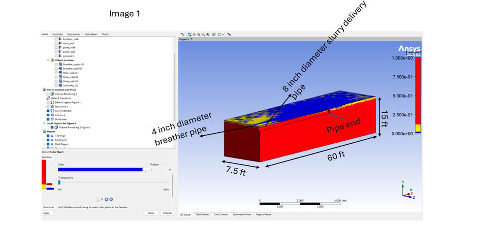

      The simulation is complete. I am in post process stage, and my goal is to see fill profile, presented in colour codes through the legend. To do this, I created a legend such that red indicates the cell is filled (100-10.1), Yellow is intermediate colour (10-0.1) and finally blue (anything between 0.1-0.0) is unfilled cells (presence of air) as seen in image 1.

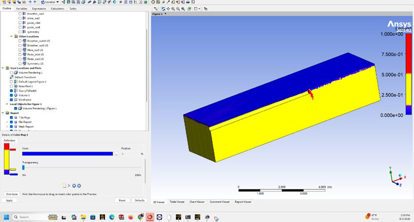

      I then created a second legend with the same aim, but this time around I assigned red colour a value between (100-50), yellow an intermediary of (49.9-10.1) and blue between (10 and 0.0). I am not able to view the actual expected filled cells, the bottom part is entirely yellow (see image 2). I expected to have the red colour on the bottom which shows the cells are filled, and subsequently yellow as an intermediary and blue at the top part. Please help me get a clear understanding of how to deal with the legend and colour coding so that I get the needed view.

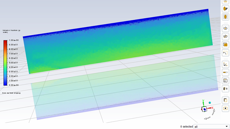

      In Fluent plot a contour on the z-centre plane of phase fraction (for each phase) and post those. What multiphase model did you use, was it granular and what is the packing limit?

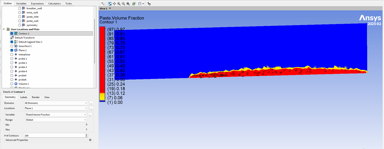

      OK. Put a phase volume fraction contour down the z-centre plane in Fluent, leave the scale as 0-1 and turn off node values. With two VOF phases it should be red/blue in the second image so I wonder if the solution has gone wrong.
      Also check the viscosity, which nonNewtonian model did you use?

      The simulation is now complete, and I am in the post-processing phase, aiming to visualize the fill profile. I created a volume and a corresponding legend for the isovolume: red shows filled cells (100- 10.1), yellow indicates intermediate levels (10- 0.1), and blue (0.1- 0.0) represents unfilled cells (air presence), as shown in Figure 1.
      Uploaded Image
      Figure 1: Red >100–10.1, yellow >10–0.1, blue > 0.1–0.0. The picture looks closer to what I want (filled at the bottom, air at the top).

      I then created a second legend for the same purpose, but this time I assigned red a value between 100 and 50, yellow an intermediate range of 49.9 to 10.1, and blue from 10 down to
      0.0. However, I can't see the actual filled cells I expected. The bottom section is entirely yellow (see Figure 2). I expected red at the bottom to indicate filled cells, followed by yellow as an
      intermediary, and blue at the top. Please help me understand how to properly set up the legend and color coding so I can achieve the desired view.
      Uploaded Image
      Figure 2: Red = 100–50, yellow = 49.9–10.1, blue = 10–0.0. The bottom is entirely yellow. I do not see a red-filled zone except at paste_inlet.

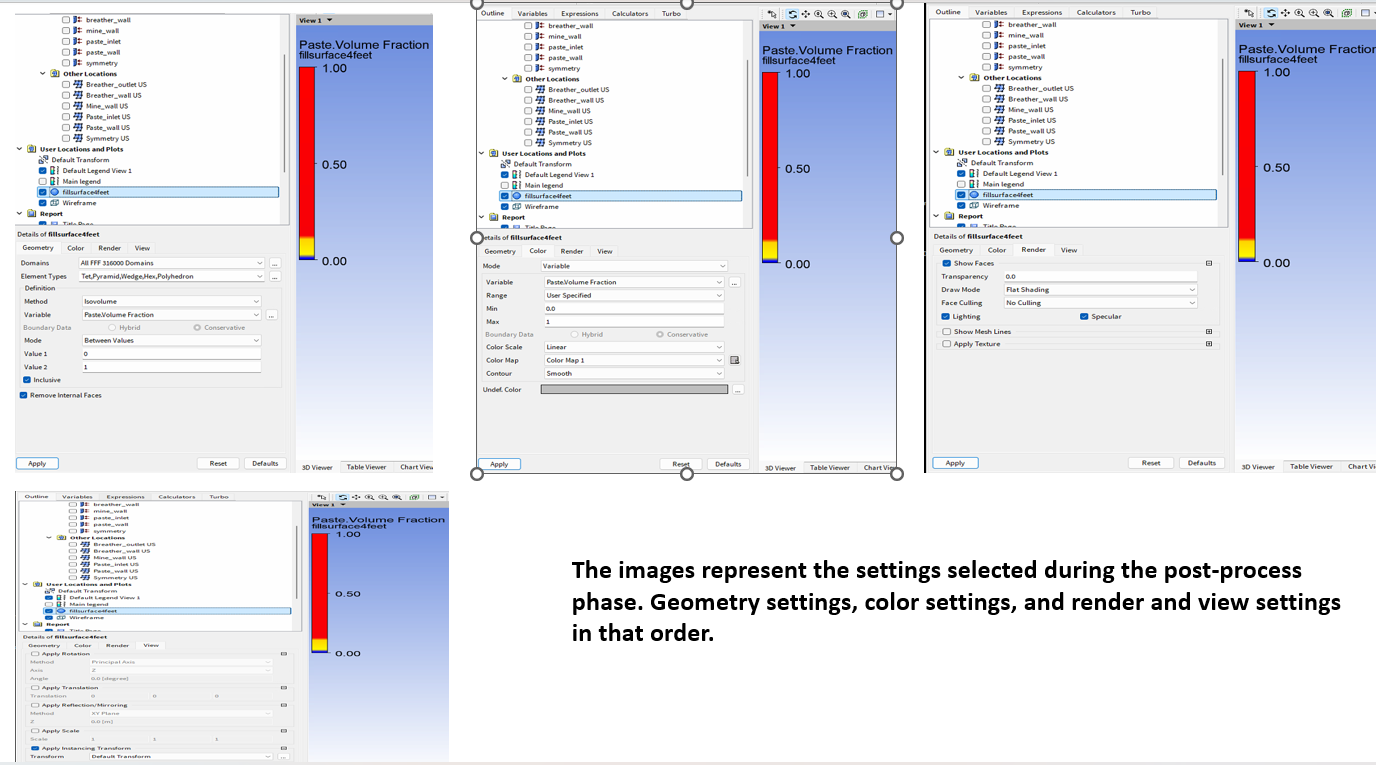

      Figure 3: Geometry settings selected
      To help me get this visualization right,
      ➢What is the correct way to set a 3-color user map for this fill profile?
      ➢For VOF, should the color map use a 0–1 scale instead?

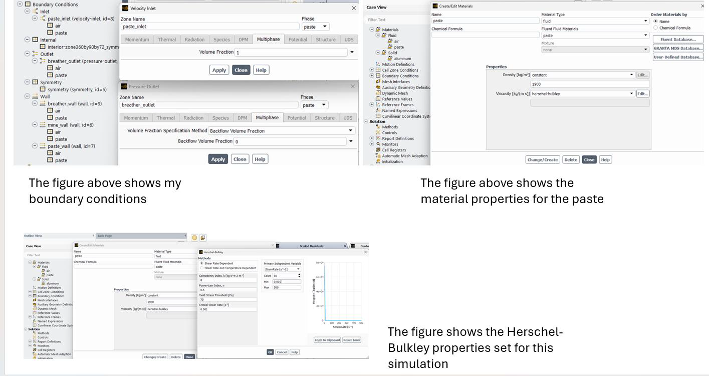

      The Herschel-Bulkley parameters used in the baseline CPB simulations were theoretical values selected from the literature reviewed for this study. The final Fluent implementation used a yield stress τy = 75 Pa, consistency index K = 8 Pa·sⁿ, flow index n = 0.5, and a critical shear rate of 0.001 s⁻¹. Because the Herschel-Bulkley formulation was regularized with the critical shear rate, separate minimum and maximum viscosity limits were not independently prescribed.
      Uploaded Image
      Figure 4: Materials and boundary conditions for the simulation
