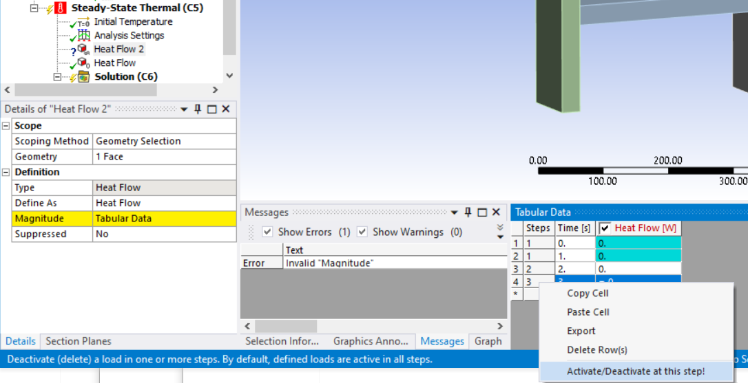

      You are better off trying an override method. You could almost do it by inserting a "Perfected Insulated" condition, but it doesn't have a table to deactivate for some load steps. And a "heat flow" won't accept a zero entry only
      But you can write the APDL file with a heat flow with a zero entry, a nonzero, and a deactivated step to see what it writes, then use these commands in your own command snippet.

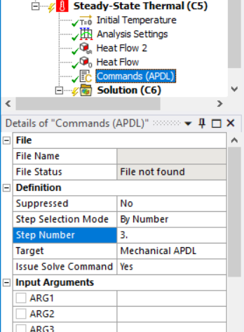

      In the details you can set the load step for which a command snippet applies:

      The above heat flow with 0,5,0,inactive steps produces:

      If your commands issue a solve, you should turn it off in the details so mechanical doesn't issue it's own solve:
      But, yes, this screws around with the way Mechanical wants to solve for the load steps, so you have to know what you are doing. And the commands are looping through its own load steps, so that's going to screw around with the load step numbers Mechanical understands. Usually when you take over the solves in a command snippet you handle all the solves there, and don't have Mechanical do any solves. Set the "Step selection mode" to all, and "issue solve command" to no, and Mechanical won't do any solves. Your script then handles looping over all load steps and the solve for each one. Your heat flux will only be applied within your commands, not with a native Mechanical "heat flux" in the Outline.
