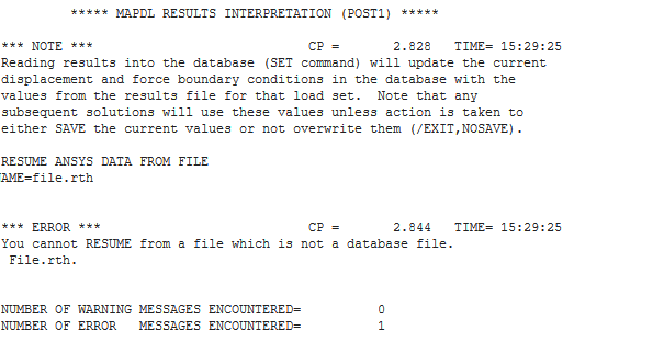

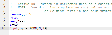

      I am trying to fetch data from a thermal analysis using a command object. as shown below, but I am getting file resumption error message in the out file. what is missing here ?
    • Factoo,Anjum
      additional info. I am inserting the command object after solution is complete

      We do not use resume here – since you are in post1 we have the result file and can post process as needed.
      (Also the resume is for a database file as it says not a results file - see the help manual for more info on this command)
