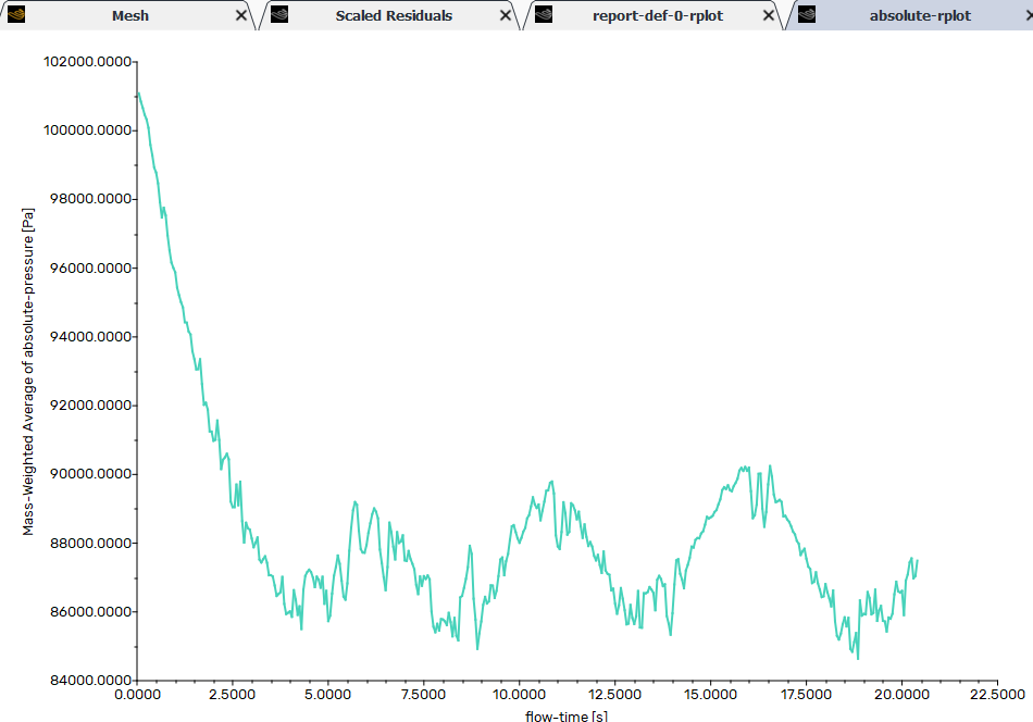

SubscriberHello Ahmed. As per your direction, I turned on the cavitation model and established it between the phases of water-liquid and water-vapor. I set the operating pressure to 101325 Pa, specified operating density to zero and the reference pressure location to liquid level.Â
My simulation runs really well and I do see water being lifted up by the pump and the absolute pressure keeps dropping near the pump pipe interface from 101325 Pa as per the rho*g*h value.Â
However after a certain number of iterations, reversed flow starts at the outlet, followed by inlet and consequently the pressure at the pump/pipe interface doesn't drop anymore(gets unstable and stagnant) i.e. the water doesn't get lifted up.Â
I tried extending the domain outlet boundary by increasing the length of the discharge pipe but reversed flow persists. This is the only issue that is stopping me from getting the suction lift time. I believe resolving this would help me in getting accurate results. Please guide.

SubscriberYes Ahmed, I'm simulating the actual rotary effect of the impeller. I'm utilizing mesh motion for the impeller with 2800 rpm and proper rotation axis (clockwise direction).Â
As of now, I'm modeling without any sort of valve behavior to make it simpler so cavitation is very abysmal as no "vaccum" is created and the residual of vof phase 3 (water vapor) drops to e-20.Â
The pressure at pump/suction pipe interface keeps dropping from 101325 as per rho*g*h where h is the rise of water. After reaching a value of 82000 it doesn't drop anymore and just terribly gets stagnant there with reverses flow at outlet and inlet warnings.
I believe reversed flow is natural and very physical in this case? There is no gradient near the outlet or enough momentum to drive the fluid outwards and flow reverses and sort of acts as a head reversal which builds up local pressure thus leading to reverse flow near inlet too.Â
Don't you think this is what would be happening in real life too? The pump ejects the primed water and this water reverses after going to a certain height and more or less oscillates at that position and thus the air above it also doesn't drive outwards from the outlet. Maybe at 85k Pa abs pressure the water gets almost ejected out and their is reversal and pump is operating on a mixture dominant by air and thus it gets difficult for the pump to lift water?Â
From experiments too, the suction lift for 3m is 35 sec, for 5m 170sec and for 7m nearly 230 sec. In my simulation reversed flow starts around t=6 sec. Maybe I need to run the simulation for much longer? What is your opinion.
As of now, I changed the outlet to mass flow outlet with very small value (0.005 kg/s) for phase air. So far, there are no reversed flow Warnings but could arise later on.Â
Please guide
