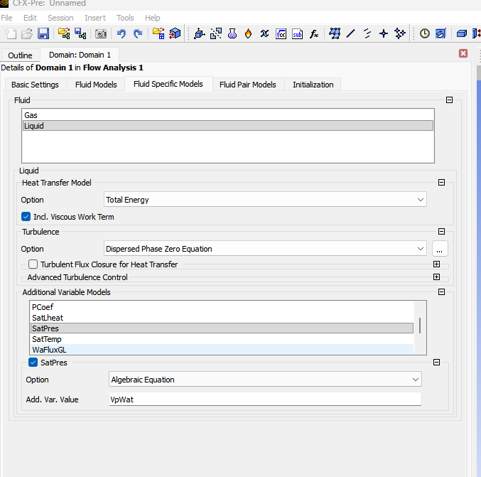

    • jcooper
      HI Riccardo:
      I doubt that the solver would fail that way for a license issue.  It seems more likely that something in the setup isn't defined or working.
      The liquid saturation pressure is also defined by an additional variable, so if this additional variable isn't activated in the domain for the Liquid, psaturation may not defined.

      END
      END
      FLUID MODELS:
      ADDITIONAL VARIABLE: FalseDt
      Option = Fluid Dependent
      END
      ADDITIONAL VARIABLE: PCoef
      END
      ADDITIONAL VARIABLE: SatLheat
      END
      ADDITIONAL VARIABLE: SatPres
      END
      ADDITIONAL VARIABLE: SatTemp
      END
      ADDITIONAL VARIABLE: WaFluxGL
      END
      ADDITIONAL VARIABLE: WaFluxLG

      FLUID: Liquid
      Additional Variable Value = DtFalseMf
      Option = Algebraic Equation
      END
      Additional Variable Value = dFLUXwadp
      END
      Additional Variable Value = HtVapwa
      END
      Additional Variable Value = VpWat
      END
      Additional Variable Value = SatT
      END
      Additional Variable Value = FLUXwa1
      END
      Additional Variable Value = FLUXwa2
      END

    • mattiariccardo01
      Hi! I confirm that the additional variable is activated in the domain for the liquid, but the problem doesn't change. I check all the domain with my eyes and, to avoid human error, with Copilot but it's seems ugual.
      Maybe the proble is how I defined the materials? I try to share with you mine CFX Command Language:

      Hey, I solved the saturation pressure problem: basically, when I imported the materials, I only took Steam3v and Steam3l, without taking Steam3vl, which instead made it run when called.
      But if I wanted to condense superheated steam (initially in region 5 of the IAPWS and therefore unsaturated), how can I do it without calling Steam*vl?
      Anyway, now Solver Managar give another erorr on the subdomain Gas2Liq but it doesn't make sense bcause I think that my input is equal to yours, I check again. In the meantime, I report the output error:
       | ERROR #001100279 has occurred in subroutine ErrAction.             |
       | Message:                                                           |
       | Failed to calculate sources in GETSOU for RESSRC_B_VOLFRC from d-  |
       | irectory "" on location "Gas2Liq". Error return code is: FAIL      |
       |                    Writing crash recovery file                     |
       | Message:                                                           |
       | Stopped in routine GETSOU                                          |
      Best regards,
      Riccardo :)
