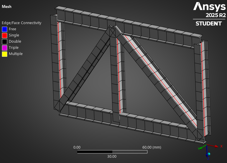

      You can close the I tab at the bottom of the graphics window to get back to your truss sketch. Now use the Create button to make beams from the lines. Every beam clicked gets the same profile.
      Click on the Workbench tab then the Share button then the green check to connect the beam ends to each other.
      When you open this file in Mechanical, you will have an I-beam structure that you can support and load.
      Go back to the Prepare tab and click the Orient button if any of the beam cross-sections are not oriented the way you want.
      In Mechanical, on the Display tab, turn on Thick Shells and Beams to see the I beam profile orientation.

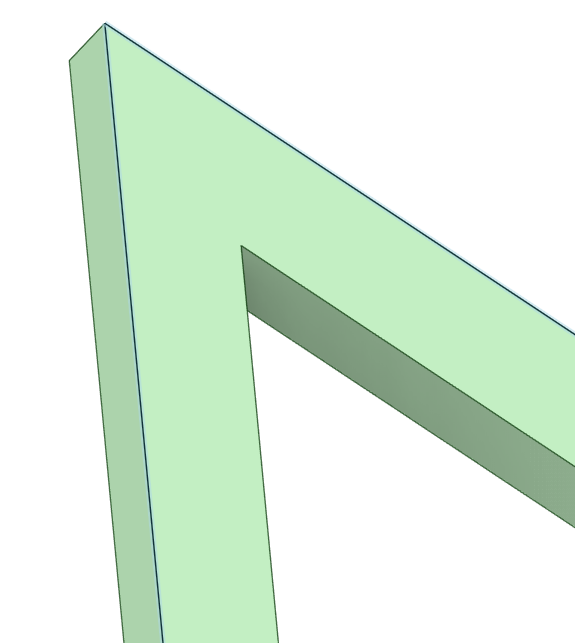

        3) As the last figure you posted shows, model is disconnected at the corners(Figure 1). But it's continous when I use "Pull" function(Figure 2). So, how can I connect it?
      1) Yes, a beam model is not a solid model.

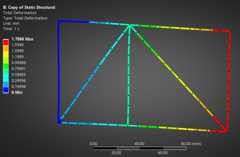

      3) The beam elements are connected at the ends. What you are seeing above is the representation of the cross-sections that are used in the calculation. Beam elements are useful for Static Structural analyses.  This image is the deformation of the beams after applying a force to the truss.
