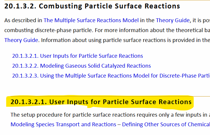

Ansys EmployeeThe combusting particle model was originally designed for coal combustion but I think the particle surface reaction model could work for your application. There are four main settings related to this model:
1.Activate the particle reaction option in the "Species Model" dialog box.
2. Select "multiple-surface-reactions" combustion model for the combusting particle:
3. Define the particle reaction in the mixture material, e.g.,
4. Define the particle composition in the injection input.
Please refer to the user guide for more details.

Ansys Employee- you need to define a particle reaction first, then the option "multiple-combustion-reactions" will appear. Sorry for the confusion in my previous message. They were meant to be key settings but not in any particular order. Anyway, the correct order is #1, #3, #2, #4 (i.e., swap the ordrer of points #2 & #3).
- The solid species is actually the fluid material type, not the solid material type.
Please refer to the user guide for more details. For 2025R2 this is in section:
