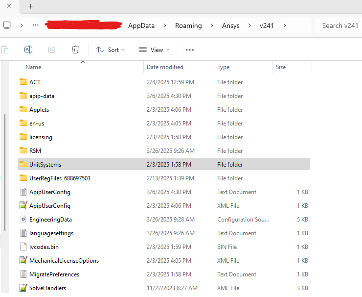

Unfortunately for me, whenever I set the units in mechanical, save, and close the application. The next time I open the workbench project the units in mechanical are resest to SI m,kg units. I have to manually change it back everytime.
From what you're saying it sounds like this shouldn't be the case and it should save the units I selected. Is there any way to diagnose what the issue might be?Â

Ansys EmployeePreference settings get saved to this directory %appdata%\Ansys\
In this directory, you will see V251 folder for version 25R1. All settings for this version gets saved here.

You do not have to manually edit files here. It should be updated automatically. Are there any installation errors? Are there any permission issues to update files in this folder?
You will see as file named software.xml where this information gets saved. This should be under UserRegFiles_#### directory.Â
Value for currentunitsys will change when you change the units system in Mechanical and close the Mechanical window
