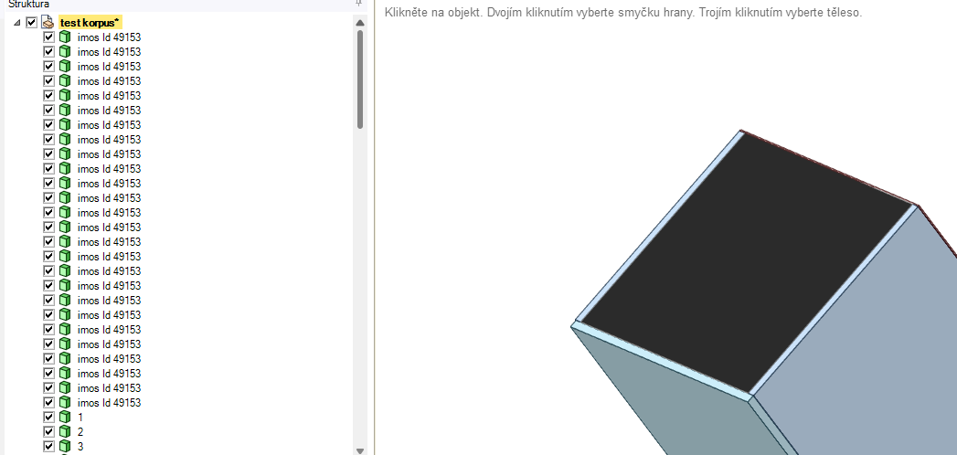

      Hello, I would like to ask experienced users a question.
      Is it possible to use a script(# Python Script, API Version = V251) to find models that are inside other models and then subtract them?
      It's about ajdustin cabinets parts, where are joints represented by model. see simple example.
      I want to find all inner models and remove them and before subtract them from whole panel.
      Now I am able to go through parts in document, but I cant find the way how create condition for it.
      Thank you for any answer.
      Kind Regards.
      Pavel

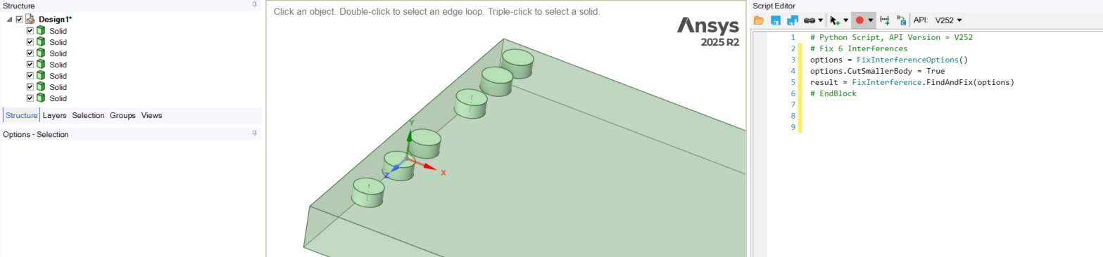

      You can record the operations in SpaceClaim/Discovery.
      Activate the script editor and use Interference tool from Prepare Tab.
      That should find and fix all the interference in the geometry.
      It will also record the command or API used.
      You can fix all the interference and also use for removing between specific selections.
      If you want to the interference to be removed from smaller body, then you need to select it from options.

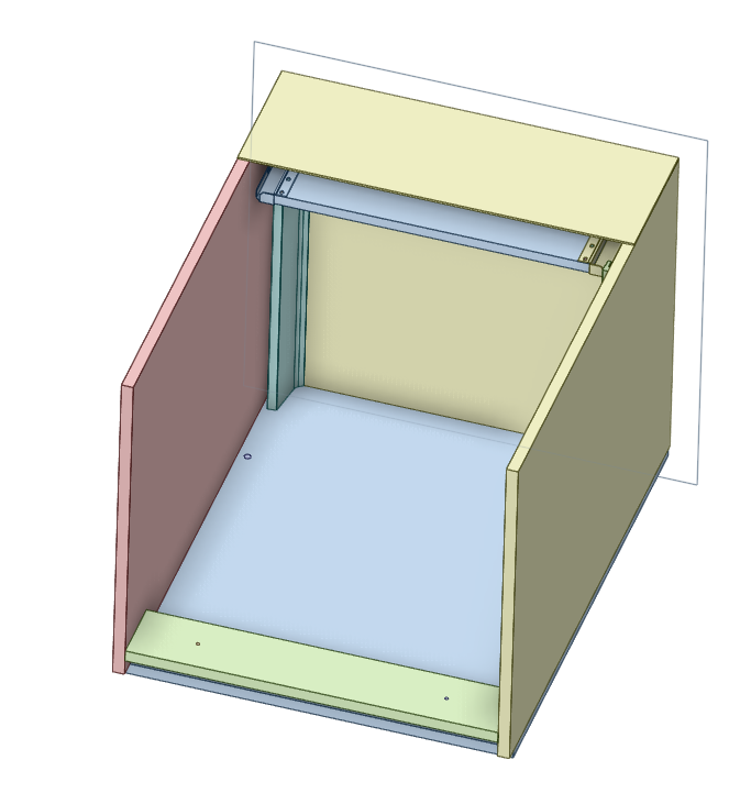

      The target is to make subtract of the models(bodies) which are all of their volume inside the another (its cabinet's parts).
      It's simplyfy for one part but in the reality there will be a lot of them. This is one cabinet from the customer as example. Whole kitchen will be here in future.

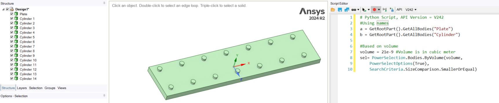

        You can create selection based on the geometry name, through named selection or use geometric details like volume etc
        Let’s assume that the parts have name plate and cylinder always.
        You can make selections using the names, volumes (cubic meter) as shown below.
        Then execute the delete operation on the selection.
        Regards
        Atharv

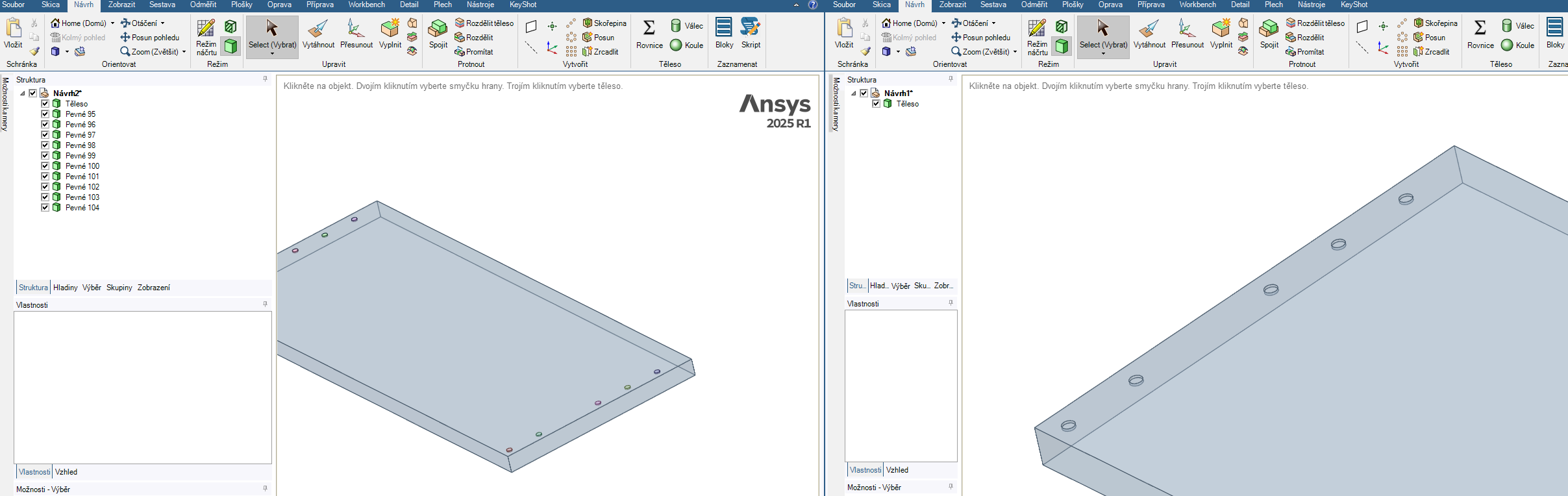

          I would like to try it but on my case the GetAllComponets.counts is giving me 0, do you know what should be the reason?
    • NickFL
      None of your bodies are in a component in that example. The bodies are under rootpart
